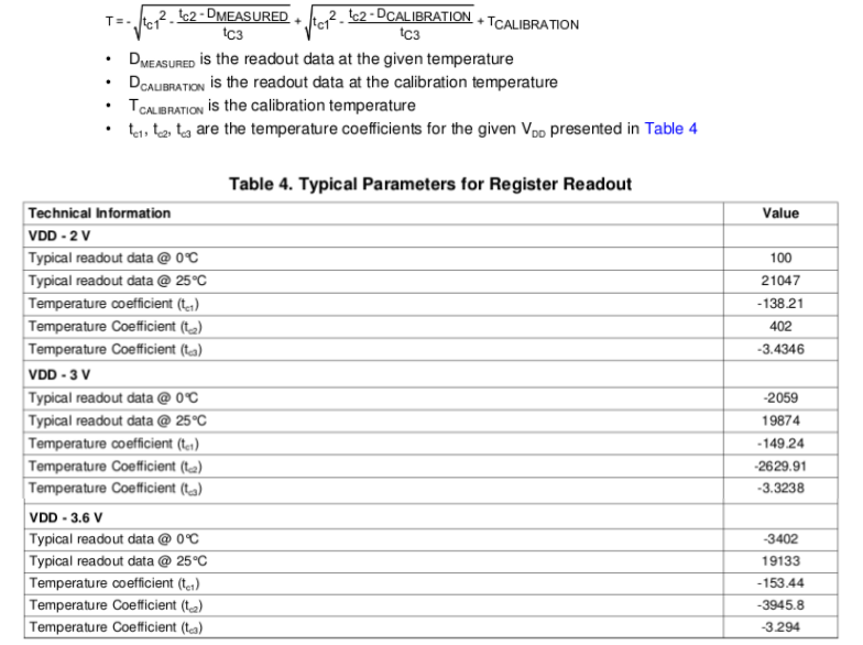

I'm trying to setup and read the temperature digitally from the CC1200 unit according to the document "DN403_B - CC112X/CC120X On-Chip Temperature Sensor - SWRA415B - Sept 2013".
I've tryed to follow the example code at the end of the document with no success.
Here are my questions
1- The register 'FREQ_IF_CFG' in table 3 (page 6) does not exist. Do you mean 'CC120X_IF_MIX_CFG'?
2- CC120X_ATEST_MODE is set to 0x07 (same val as CC120X_GBIAS1). Is this a typo? The analog set up sets this register to 0x0C...
3- Reading CC112X_MARCSTATE register gives 0x6D before entering debug mode and 0x41 after. Is this ok - no information about correct MARC state is given?
4 - The document does not say anyting about how to use the CHFILT_Ix and CHFILT_Qx registers to get the 'Digital readout'-value to use in eq (7) page 6- Some help here is REEAAALLLY appreciated.... Are they some kind of real and imaginary parts (see my next question)? and how am I supposed to use them?
5- If you try to solve the second order equation (7) in page 6 with the coefficients in table 4 on the same page there are no real solutions for digital readings above 17800 (the decriment delta is negative)... wich is below 25oC...
I really appreciate some help

  • It could look like the coefficients in the Design Note for some reason is off.
    I looked into the original excel sheet and the correct coefficients should be:
    2.0V: tc1: -3.7, tc2: 958, tc3: 385
    3.0V: tc1: -3.3, tc2: 992, tc3: -2630
    3.6V: tc1: -3.3, tc2: 1011, tc3: -3946
  • Thank you for your answer.
    I've set up the cc1200 according to your code (the registers in preferredSettings[]). I still have problems.
    I've tested the following things:
    1- I've used the exact code you've sent me: CC120X_CHFILT_I2 = 0x02 but all others are 0 (which is ok since CC120X_CHFILT_I2=0x02 means valid value CHFILT_STARTUP_VALID=1) but the data is 0 (useless). I also get status byte 0x60 (RX FIFO error) after cc120xSpiWriteTxFifo() in the run_MARC_debug() function.
    2- I've used the exact code you sent me but I've added a little code to flush the RX FIFO in the beginning of the run_MARC_debug() function and It get rif of the status byte = 0x60 issue above. But, the CHFILT_STARTUP_VALID bit in CC120X_CHFILT_I2 is now 0 and the digital readout is a little bit jumpy but around 130000....
    How do I know that the cc1200 is correctly configured and how do I use the CHFILT_Ix and CHFILT_Qx registers to get a readout that I can use to compute the temperature? Your code does not give any information about this.
    I'm referring to these values. The values in the DN403 App. Note are different from these.
    And I'm operating the CC1120 Chip at 3.3V. What will the values at that voltage?
  • As my previous mail indicate the values in the design note are wrong based on my measurements results from CC1120. If you look at the values for 3.0 and 3.6 they are more or less equal except for tc3. If you do a one point calibration the value of tc3 is to important.
  • Using the values from your earlier post on this thread, the output is erroneous.
    Aren't the values of tc1, tc2, tc3 exchanged with other values?
    For reference:
    Please verify,
  • We actually need 1 other datapoint (say T=50oC and the corresponding value). We could compute tc1..tc3 ourselfes....
    May be something to consider for the next datasheet :)
  • @50 degree the typical readout is
    2.0 V: 37996
    3.0 V: 38163
    3.6 V: 37879
