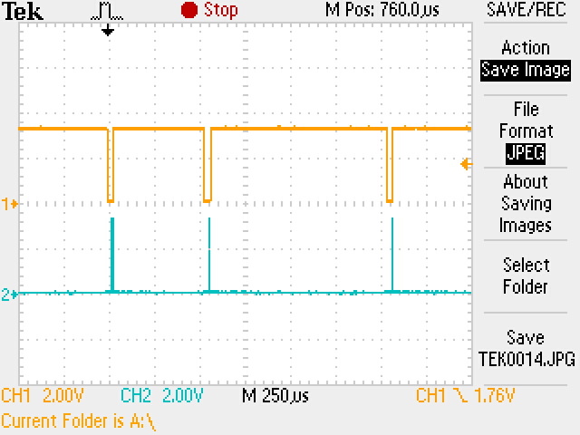

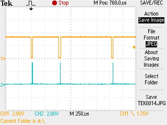

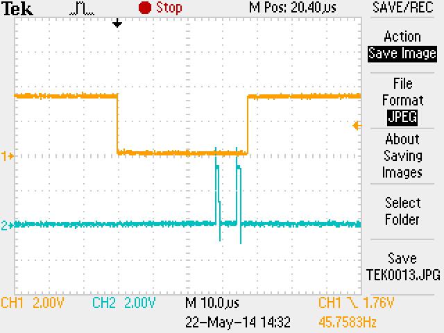

  • I borrowed a scope and taken the trace, Have a look on this.
    , top trace is CSN and bottom is SO.
  • what are  you doing in the Poll_SO_pin(LOW function)?
    This should be a check to see if MISO is low and I do not know why it is returning FALSE, because your plot shows that it is LOW and everything is fine.
    When sending the SRES strobe, CHIP_RDYn will go high for a while before going lowagain.
    You can either pull CSn high just after the reset and then remember to check MISO next time you are talking to the radio (pulling CSn low) or you can wait for CHIP_RDYn to low again before pulling CSn high.
