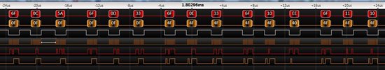

My custom CC1200 board seems to transmit on 774MHz no matter what values I put in FREQ2, FREQ1, FREQ0. Here are the steps I follow:
GPIO_write(hGpio,TX_ENABLE,1); //Enable Transceiver
trxSpiCmdStrobe(CC120X_SRES);// Write registers to radio
USTIMER_delay(1000);
cc1200_init_registers();
trxSpiCmdStrobe(CC120X_SFSTXON);
createPacket(txBuffer);
cc120xSpiWriteTxFifo(txBuffer, sizeof(txBuffer));// Write packet to TX FIFO
trxSpiCmdStrobe(CC120X_STX);// Strobe TX to send packet
What am I doing wrong?

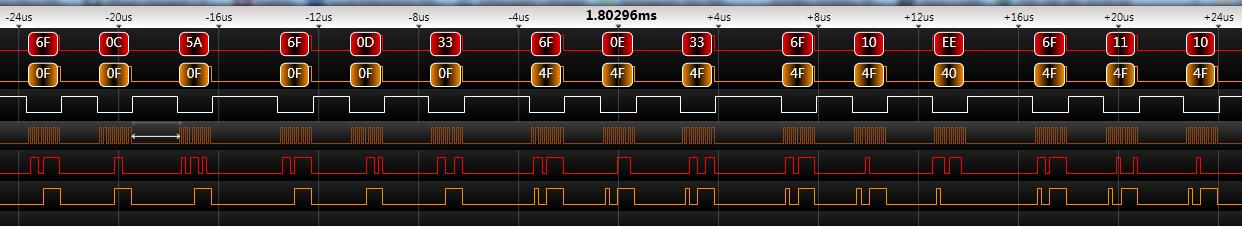

    I think it has something to do with my SPI interface timing. I am not using an MSP430, therefore I cannot use your Macros. I have built my own SPI command structure but it appears not to be working properly. For example, here are the SPI transactions during the register programming of the FREQ registers. Notice that the chip status byte indicates that the frequency synth calibration is running.
    Do I need to wait for this to complete before continuing the register programming?
