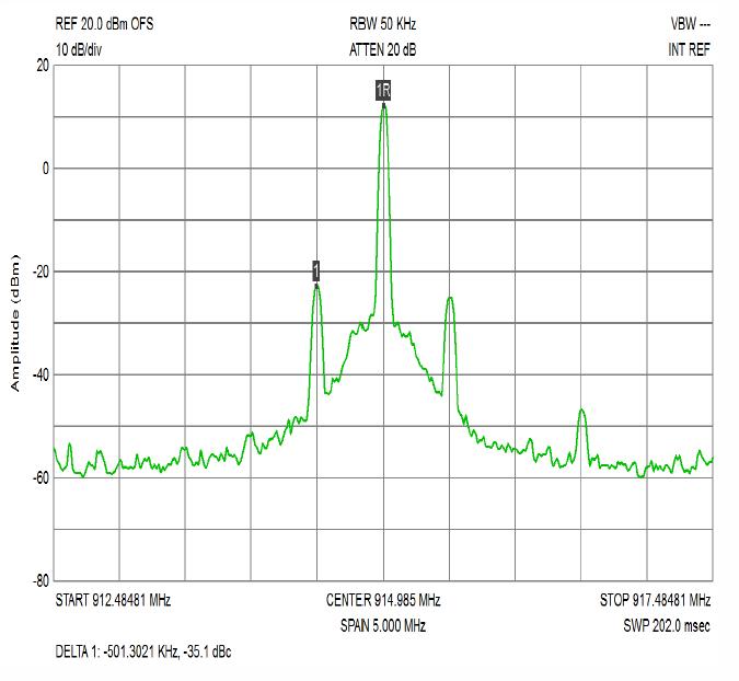

Below is a snapshot of the output of the CC1200 when configured for CW. Is this correct? Why are there sidebands at +/-500kHz?
Do you get the same spectrum if you use SmartRF Studio? I don't have access to a spectrum this week but the spectrum does not look like correct. It should be a small spur (~-60 dBm) at 920 MHz (multiple of the xosc frequency) but no other spurs should be visible.
What hardware are you using? If it is your own HW, have you tried a CC1200 EM? Do you see the same? If it is your HW, could you post the schematic and layout for us to look at? How do you power the board? As TER said, we do not have instruments this week so we appreciate that you can help us debugging.
Sorry guys. I must have had something set incorrectly (i.e. modulation). Here's the correct CW spectrum shot. Spurs are at ~-65dbc @+/- 18.5MHz from fo. (TER did you mean ~-60dbm or dbc?).
To answer your questions, it is my own HW and layout. But I did carefully follow the ref design. It appears to be working fairly well now that it is configured properly.

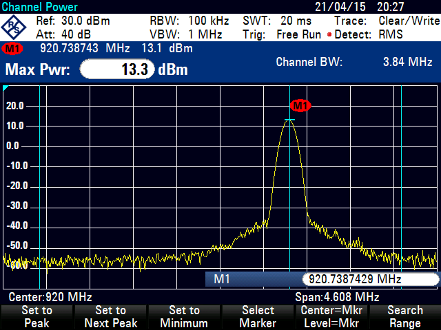

Hello TER,

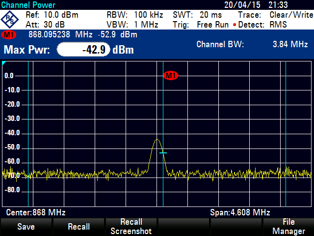

Well, seems like I solved one problem creating another... Now, the signal from CC1200 is very weak.
Check out, the spectrum.
Note, it's official TI eval kit in 100kbps , continuous TX mode. Settings come from SmartRFstudio. No changes.
Any suggestions, how to get back to +14 dBm ?
BR,
Iurii
Have you checked that the SMA is selected and not the PCB antenna? It should be default but make sure the PCB antenna is not used.
Hello Mike,
I checked RP-SMA, as you mentioned. The adapter is correct and plugged properly.
I am wondering, could that be a register setup?
Can you, please, share your settings while having +14 dBm output power as shown on your plot?
This might help a lot.
Thanks in advance,
Iurii
