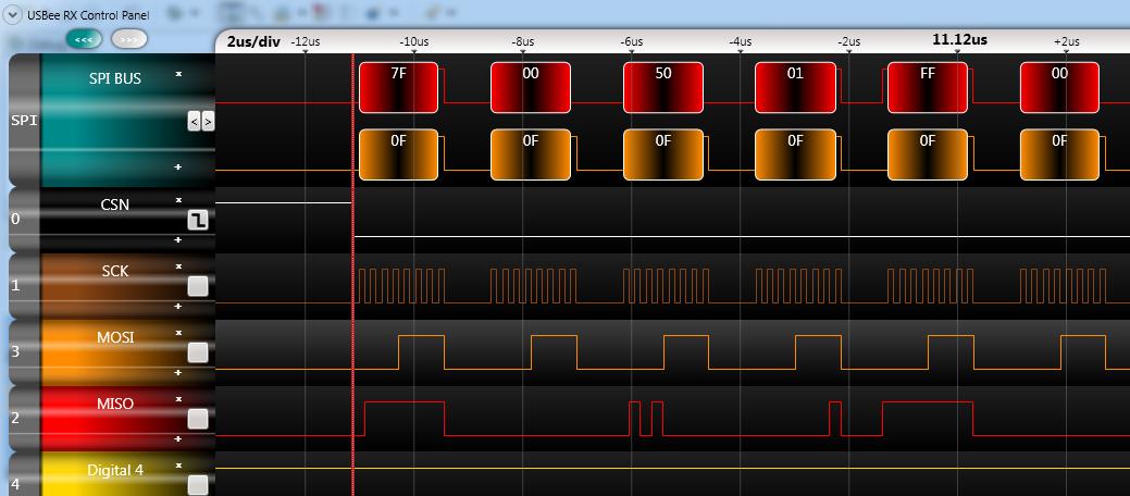

I am having trouble writing to the CC1200 TX FIFO without over/under runs. I have configured my TX packet to be variable length and given it a length of 80 bytes (0x50). Below is a screenshot of the SPI write to the FIFO starting at FIFO address 0x00 (0x7F, 0x00) followed by the length byte of the packet (0x50), then the data in the packet.
But after sending a TX strobe command, then reading TX Start, RX End, and NUM_TX_BYTES, I get the following SPI values. Notice that TX Start is 0x00, TX End is 0x4F, and NUM_TX_BYTES = 0x4F, which tells me that the TX burst sent only one byte.
Can someone see what I may be doing wrong?
  • Hi Mike
    Why are you sending 0x00 after the FIFO address? A standars FIFO access is only 1 byte long (see Table 3 in the data sheet). The 0x00 will be the length byte so this is why you are only sending one byte.
    BR
    Siri
  • Ah, good catch. I was experimenting with the direct access command and forgot to get rid of the address byte when I switched to the standard FIFO access.

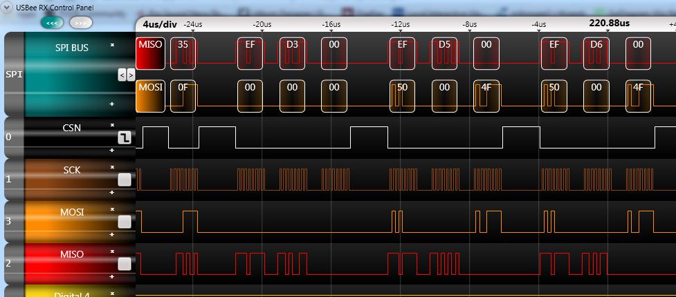

  • I have TXOFF_MODE = IDLE. I strobe STX for each packet and then wait ~3ms before sending the next packet. Each packet is ~700us, so the FIFO should easily be empty before I attempt to load another packet into the FIFO. The only way I can successfully transmit consecutive packets is to flush the TX FIFO before each packet is loaded into the TX FIFO.
    Here is a snapshot of the status of TX_START, TX_END, AND NUM_TXBYTES after loading the FIFO, then after STX. Notice that now the TX_START does not change and NUM_TXBYTES remains at 80 (0x50). However, the packets ARE being transmitted and I can see them on the spectrum analyzer.
    Also notice that the SPI status byte begins showing 0x50 when reading TX_END and NUM_TXBYTES at the end of this transaction.
    What could I be doing that keeps the TX_START pointer from incrementing?

  • Sorry, there is a slight error in the SPI transaction above. Reading the TX_START, and NUM_TXBYTES immediately after issuing an STX command will not give the chip enough time to send the packet. So these values are not correct.
    However, after moving these commands to the beginning of the next transaction shows that
    TX_START = 1;
    TX_END = 50h;
    NUM_TXBYTES = 4F;
    which says only one byte was sent from the FIFO.
    But when I look at the spectrum, I can clearly see that the full packet is being transmitted. Since I flush the FIFO before each transaction, I am able to continuously send packets. But I would like to find out why the FIFO pointers are not behaving properly.
    Any suggestions of how to debug this would be appreciated.
