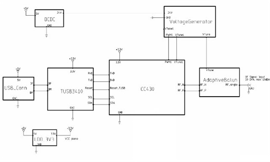

I was wondering if there is a way of making any 'variable frequency balun' or adaptive balun which can be tuned in the circuit for any specific transmitting or receiving frequency. The radio module will have a wide range of frequencies covering most of the sub 1 GHz ISM bands. Eg: CC1101. If I have to use a wide band, say from 315MHz to 915MHz, I have to change the balun circuit and mostly its component values. I don't want to use multiple balun chips like the JTI ones in a single circuit. Is their any way I can make it adaptable for all frequencies I wish to work with? Something like the SA430 USB Spectrum Analyzer have???

  • Okay. So I now understood that high frequency balun can also be used for low frequency 'listening' only. Then let's assume I will be receiving signals in a central hub from multiple transmitters of different bands. My problem is solved with 868/915MHz balun.

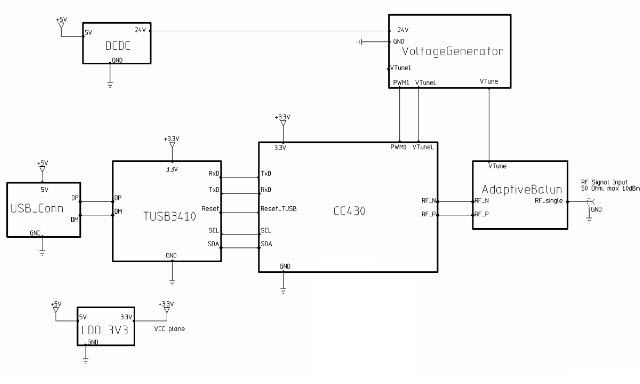

    Instead of SA430 circuit, I would like to talk about the theory behind its adaptive balun. If talking about SA430 block diagram, a DC/DC converter is used to provide upto 24V, directly between antenna's DC coupling and the balun circuit, with an amplifier if I am not mistaking. Could you suggest me what is the 'theory' behind it? How it is going to help in adapting the balun for different frequencies? Whether it is compulsory to use such circuit???
    Thanks a lot...

    The balun we use on most of our designs is based on two filters connected in the middle forming a balun circuit. The filters are a low-pass filter and a high pass filter, at the cut-off frequency they each provide 90 degrees of phase shift in opposite direction and when connected they provide a total of 180 degree phase shift before combining the RF power. This creates the balun function needed.
    This circuit works over a pretty large frequency range, a 1:2 type frequency range, but if you need more tuning range than 1:2 you need to enable some way of moving the filter cut-off frequency - this is where the adaptive balun comes in.
    Sverre is, in the statement above, warning you of the difficulty in creating a variable cut-off frequency balun that will at the same time create enough attenuation during TX to pass regulatory requirements around the globe. But this could be achieved if you also implemented variable cut-off frequency low pass filtering in the final output stage.
