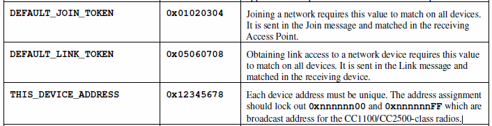

I am want to use the simpliciTI (unrestircted 868.8MHz) for CC1111 dongle and trying to understnd the simpliciTI working.Can someone help me out with the below
a)How to assign values and what values should be assigned for the below described
1) DEFAULT_JOIN_TOKEN, 2) DEFAULT_LINK_TOKEN, and 3) THIS_DEVICE_ADDRESS.
b)IOCTL_LEVEL_3
Where can I see the assinged(I mean which code of lines define these) values for the above a) and b) in the simpliciTI code of CC1111 provided by TI.
Thankyou.
    The DEFAULT_JOIN_TOKEN and DEFAULT_LINK_TOJEN can be found in smpl_nwk_config.dat, while THIS_DEVICE_ADDRESS can be found in smpl_config.dat. See the following screenshot from your IAR SimpliciTI project view:
    stefan 12 said:
    b)IOCTL_LEVEL_3
    DEFAULT_LINK_TOKEN is initial value of sLinkToken (see nwk_link.c)
    DEFAULT_JOIN_TOKEN is initial value of sJoinToken (see nwk_join.c)
    THIS_DEVICE_ADDRESS is initial value of sMyROMAddress (see nwk_globals.c)
    All value can be changed during run time using the SMPL_Ioctl() function. See the documentation for detailed information.
