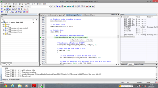

    I had modified the easy link code to run on an ARM core controller. I was able to send packets, but could not receive any packets.
    Then I tried to run the original Easy link code on the TRxEB (+CC1125.) I was getting the same problem.
    I have ensured that the GPIO2_CFG value is 0x06.
    I also tried to debug the code and it was getting stuck due to the value of the variable packetSemaphore not changing to 1.
    Is it the PKT_SYNC_RXTX status signal not asserting on GPIO 2? If so why?

    Here is a screen shot of the code in debugging session (the pointer is at the line where it is stuck)
  • By first look the settings you are using are for a 32 MHz crystal, the CC1125 EM most likely using a 40 MHz crystal.

    But we checked with Smart RF Studio and our registers are set for 40MHZ not for 32MHZ.

    Gives a RF frequency equal to 1085 MHz with 40 MHz crystal but 868 MHz with 32 MHz. I assumed you wanted 868 MHz?

    Point is - Currently i am using  original Easy link code available on web to run on the TRxEB (+CC1125.)
    I didn't change anything in code and still not able to receive the data whereas previously it was working.
    Is this issue is related to hardware?
    ( I purchased CC1125 development kit  for testing(http://www.ti.com/tool/cc1125dk).Downloaded the easy link code from net and tested the same on this kit. It was working and i was able to receive the data. Then i used CC1125EM board with ARM based controller. SPI was working but not able to receive the data. To see the issues i again tested the CC1125EM board with SmartRF Transceiver EB (TrxEB) and then same problem occurred in  this kit as well.)
  • The Easymode code is for CC1120 with a 32 MHz clock. You have to change the frequency dependent registers for this to work, 1085 MHz is outside the supported band of the chip. Use SmartRF Studio and change from 32 MHz to 40 MHz to see which registers you have to adjust. Note that one of the ADC registers also has to be changed.
