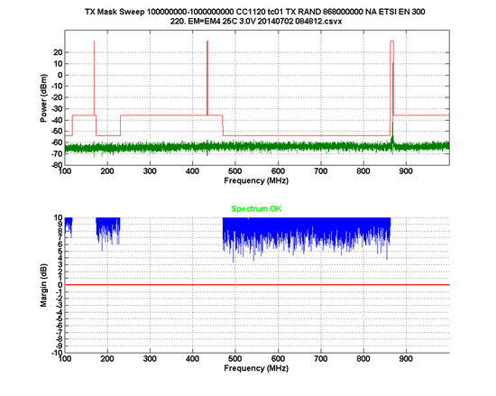

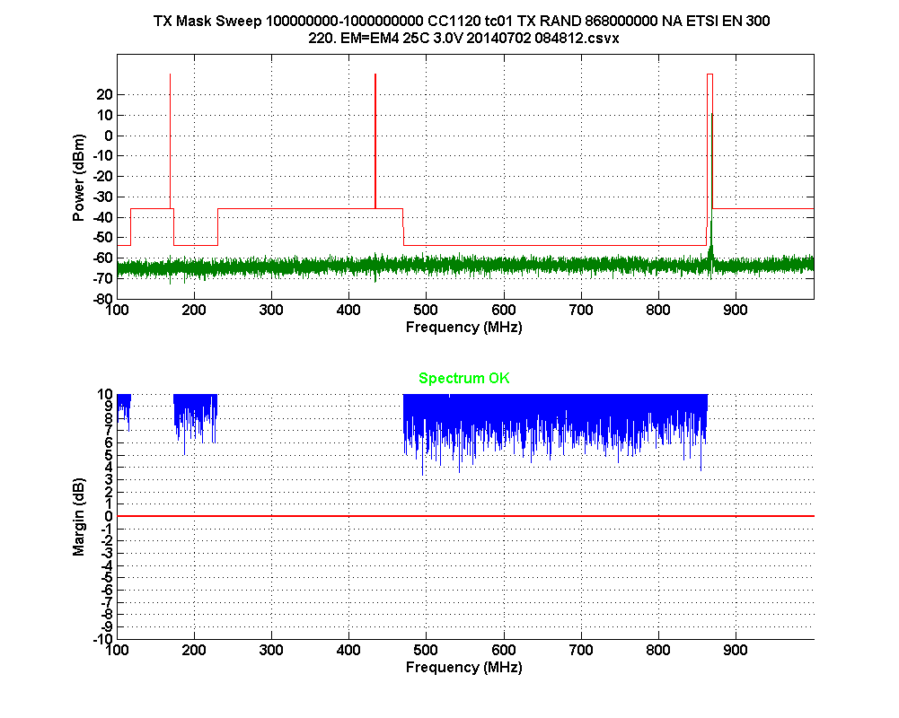

I am unable to find any data for conducted measurements regarding spurious levels below 1 GHz when using CC112X and Murata/Johanson IPC.
The datasheet for CC112X defines < -60 dBm @ 869.5 MHz TX, and < -57 dBm RX. These are for the lumped elements version of the EM.
Has measurements been done for the IPC version?
Or is it OK to assume similar data for for IPC version?
The only data I can find for IPC is regarding harmonic emissions.
