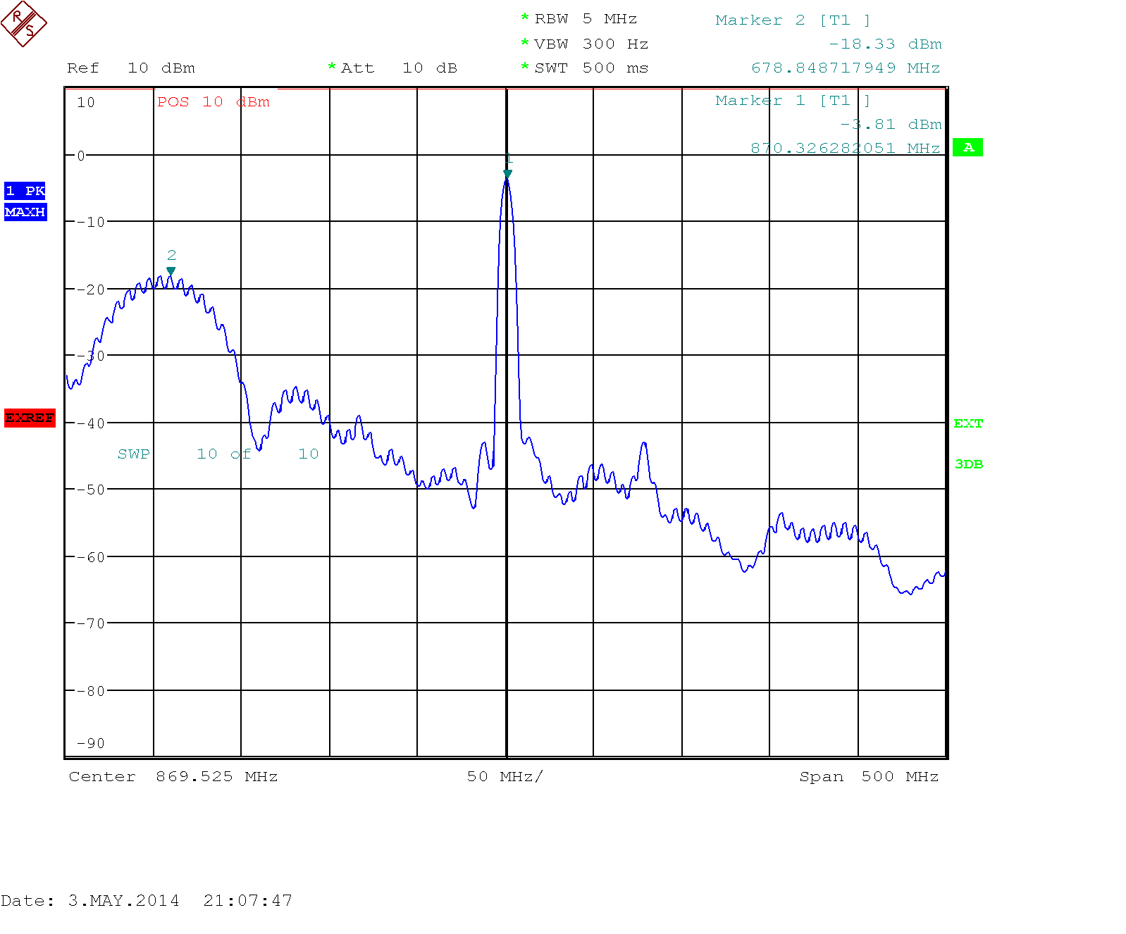

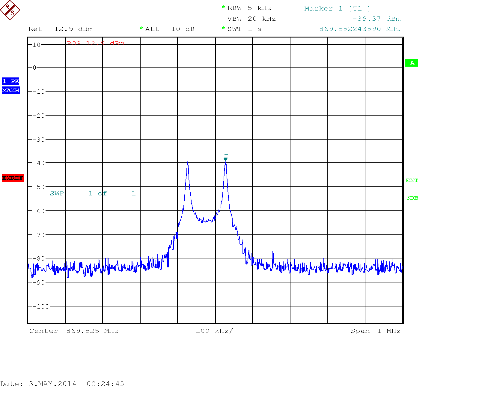

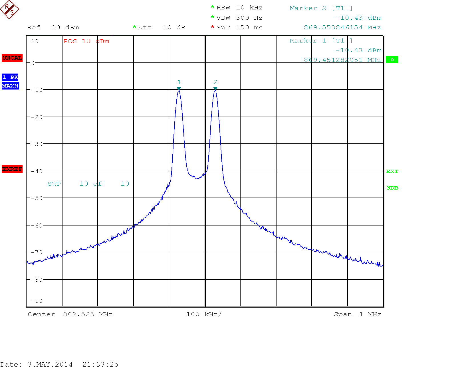

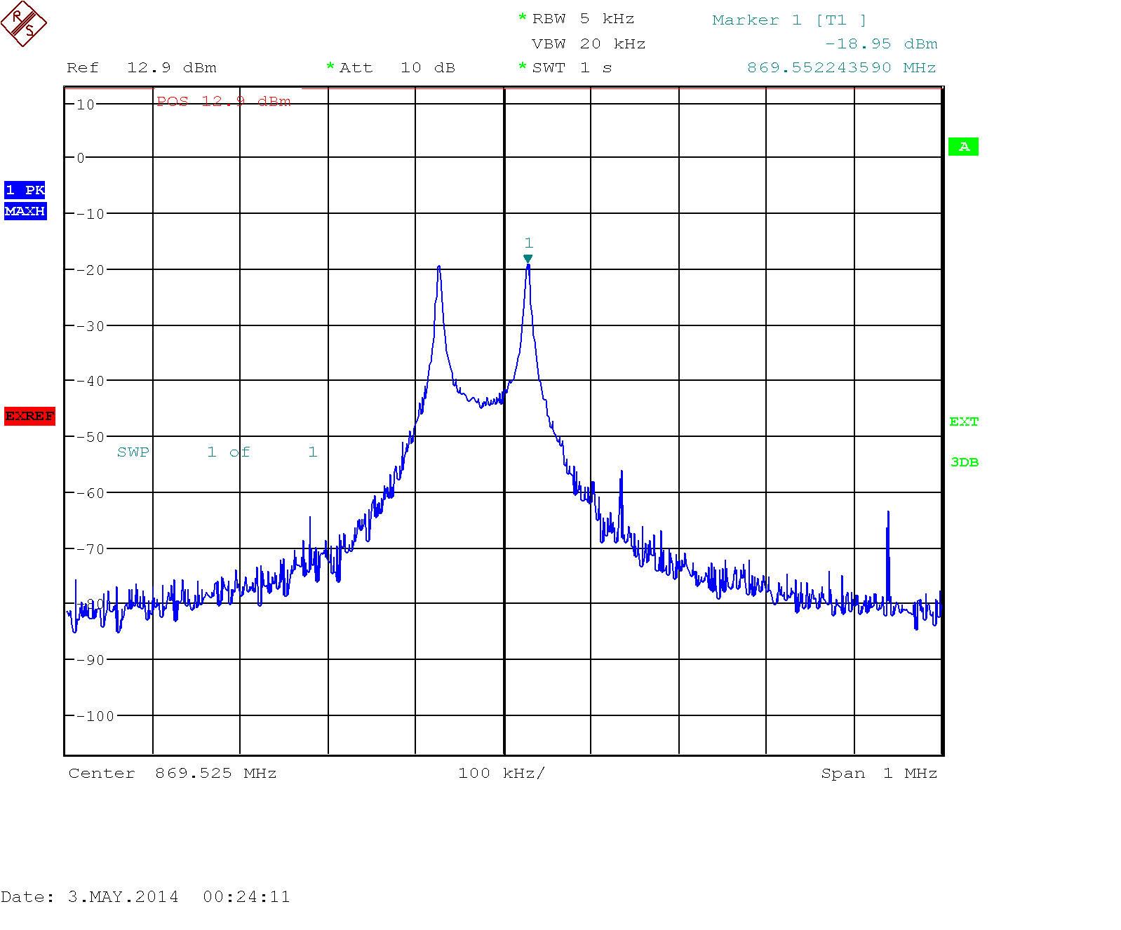

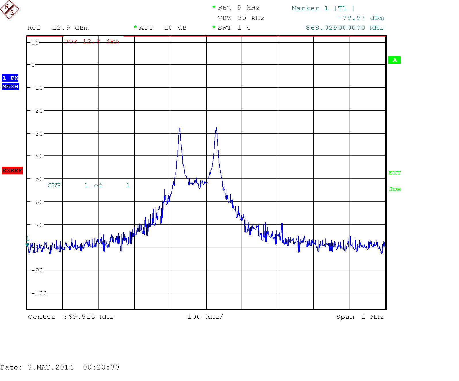

A look at the spectrum analyzer revealed that the noise seems to be amplified but not the signal itself. These values were conducted by using a test probe to pick up the values directly from the pcb. Therfore the exact amplitudes in the plots might not be accurate.
Signal in front of the CC1190 (CC1190 enabled):
Signal behind of the CC1190 (CC1190 enabled):
Signal in front of the CC1190 (CC1190 disabled):
Signal behind the CC1190 (CC1190 disabled):

  • 1. Can you remove the SAW filter from the board and measure the conducted output power with a 50 ohm semi-rigid cable instead of a probe so the exact conducted output power from CC110L can be measured at C123 ?
    Measure the output power with a static tx carrier.
    2. Remove CC1190 and assemble SAW filter. Measure the conducted output power after the SAW filter.
    Need to confirm the conducted power entering CC1190.
    Regards, Richard

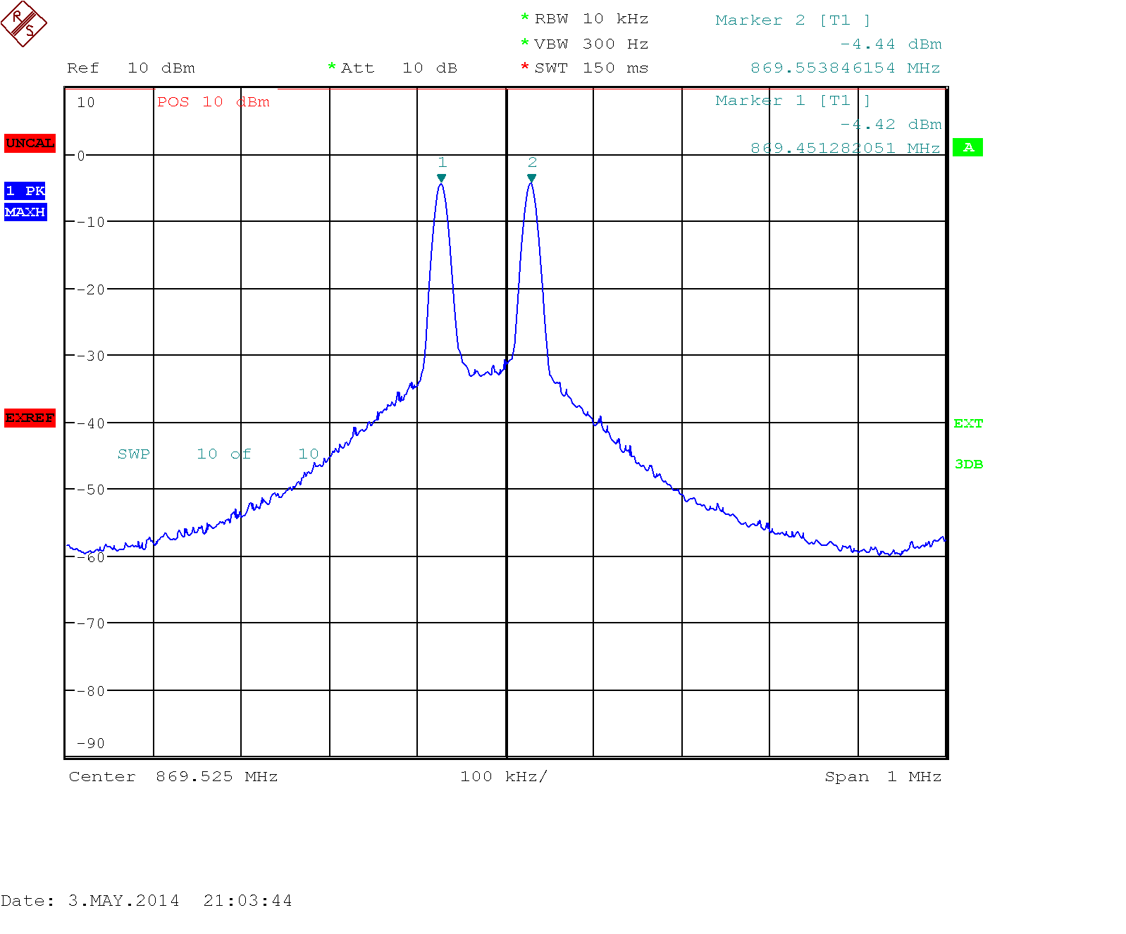

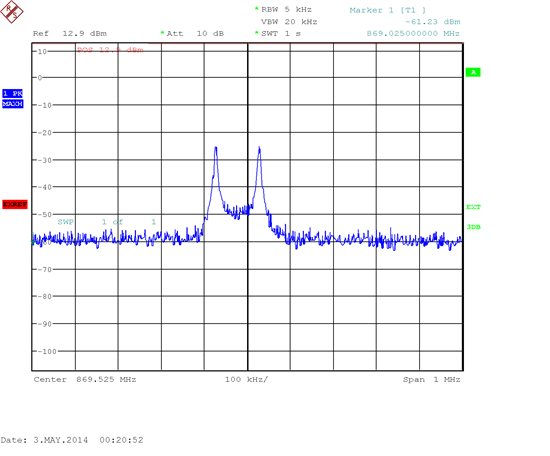

  • Thank you, Richard, for the quick response!

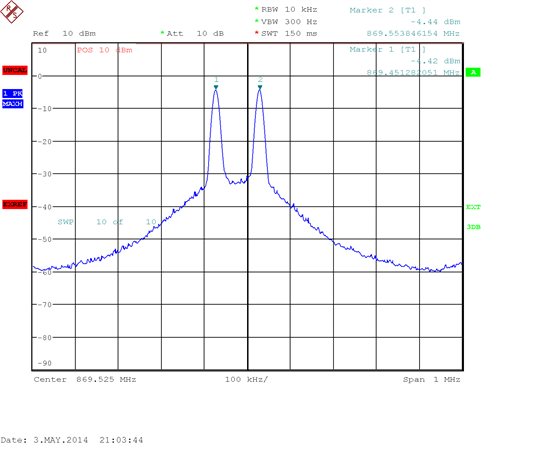

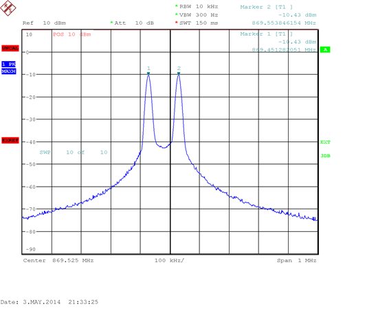

    Appended you find the requested plots. I made all measurements with the output power set to PA_TABLE0 = 0x54. I also used the CC110L to transmit a continous random signal (PKTCTRL0 = 0x22; MDMCFG2 = 0x08; IOCFG0 = 0x0C).
    Static Signal 1MHz span, measured behind C123 with removed SAW:
    Static Signal 500MHz span, measured behind C123 with removed SAW:

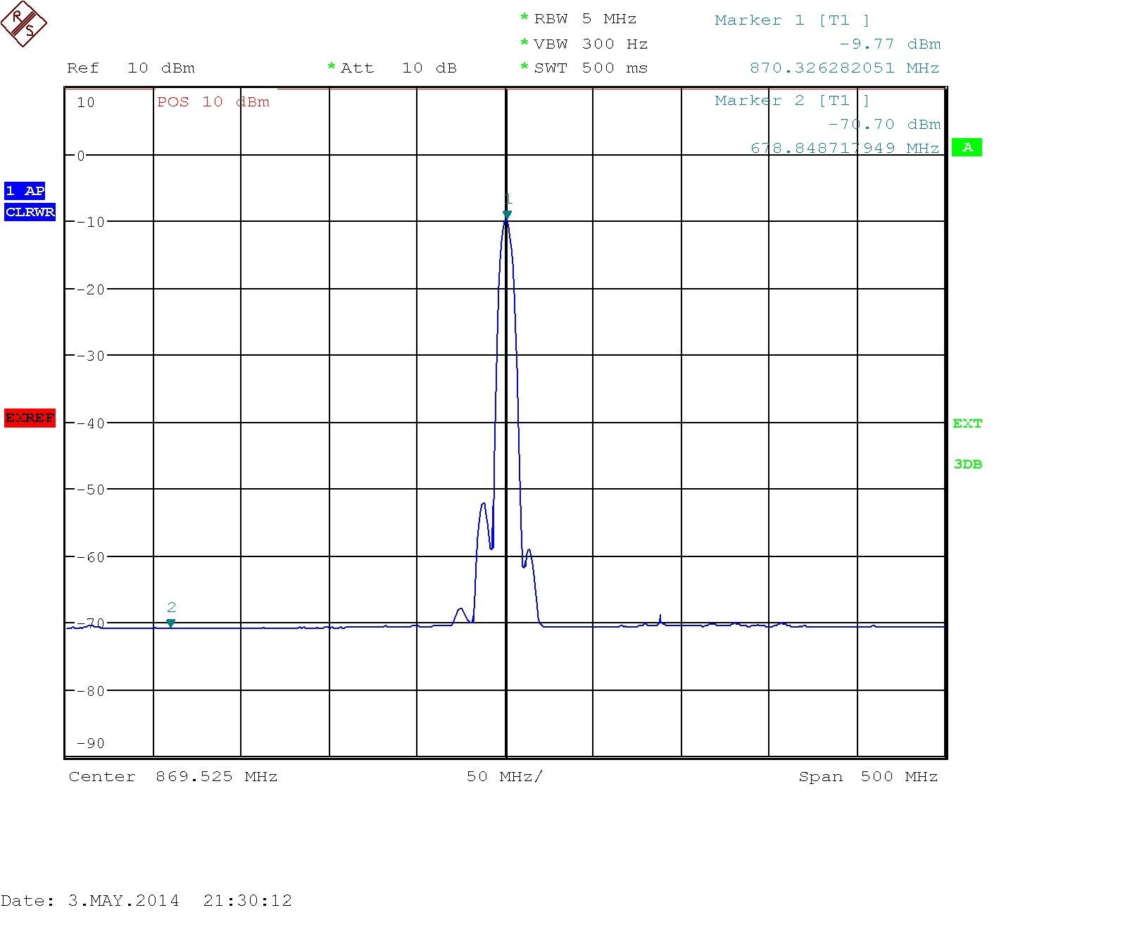

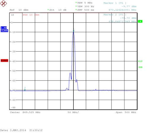

    Static Signal 1MHz span, reassembled SAW, removed CC1190:
    Static Signal 500MHz span, reassembled SAW, removed CC1190:
    Regards, Emil Kallias
    Your output power levels from the CC110L are low. I would expect around 0 dBm and you are measuring around -4 dBm and after the SAW filter I would expect around -2.5 dBm and you are measuring -10 dBm.
    The layout does not look good and I presume that this is the root cause. It appears that your design is a 2-layer board with very little grounding especially around the RF sections.
    Regards,   Richard
