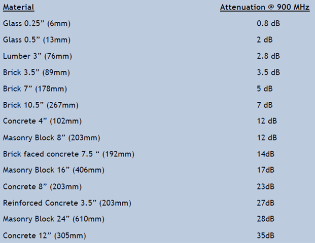

  • When calculating a link budget, normally a certain guard band is added for additional link margin (typical 10 dB).
    When calculating the link budget / range for indoor applications, I normally use the following figures in addition to the link margin:
  • I would expect that the 868 MHz link with 500mW output power will have a greater range:
    • 868MHz-500mW : approx. 7500m LOS range expectation with a typical antenna loss of 1dB
    • 433MHz-30mW   : approx.4800m LOS range expectation with same typical antenna loss of 1dB (which is not feasible unless the antenna is very large)
    • 433MHz-30mW   : approx.2200m LOS range expectation with a typical size antenna loss of 6dB

  • Here is an excellent link which summarizes the attenuation through different building material from 500 MHz to 8 GHz:
    http://www.eiwellspring.org/tech/Shielding_by_building_materials.htm
    Regards, Richard
  • Great, thx.
    What I read out is that 500M vs. 1000MHz makes about 4-5dB difference.
    What makes me wonder is that this difference remains the same regardless how thick a wall is. I suspected that the more walls are in between, the less a higher frequency performs.
    This would also explain our findings.
    But this table explains only 4-5 dB, where disappear the remaing ~7dB out of my 12dB higher output?

  • If your antenna is a wire and it is cut to a quarter-wave then this is ideal for a low frequency like 433 MHz. Then as mentioned in an earlier comment; for the same antenna performance, the distance would be:
    and to compensate for the material absorption between 500 MHz and 1 GHz is 5 dB; then the "compensated LOS" range would be:
    • 433MHz-30mW   : approx.6900m "compensated LOS" range expectation with same typical antenna loss of 1dB
    If your device would of been an hand-held device then the area for the antenna is limited. For 868 MHz, a good antenna can be achieved but for 433 MHz, the antenna losses start to increase due to the limited size.
