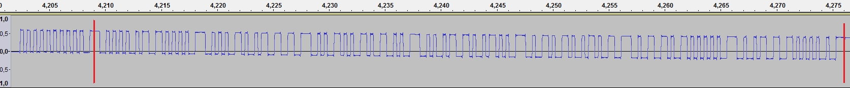

data which looks like this
i want to receive with a cc1101 on a RF04EB and Smart RF Studio.
This data was received with a AM receiver on 433,92 Mhz. So the modulation is ASK and the data seems to be
Manchester encoded.
How to configure cc1101 to set to a 10bit preamble?
What Data rate to set?
And how to calculate the RXfilter BW?
We see three pulse withs, how the cc1101 handles the longest pulse, which seems to have no function?
  • If the data is manchester coded the longest pulse is a manchester violation.

  • The longest pulse seems to have no impact on the information. When i decode the data with manchester, i get the information i need. So the data is definitly manchester encoded. How the cc1101 handle the longest impuls?

  • I would assume that a pulse that is a manchester violation will be decoded as a bit error.
