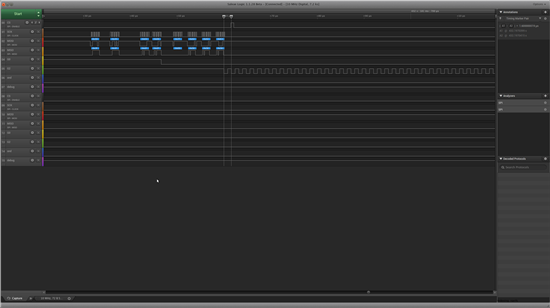

I do not assume that after successful CCA radio goes automatically to SETTLING or to some other state from TX. However this exactly sometimes happening. Fortunately I was able to catch it with logic analyzer. Channels 0-7 are device 1 SPI trace and channels 8-15 are device 2 SPI trace. Notice that these devices are sending almost at the same time. Device 1 start 9 us earlier that device 2.
Look device 2 SPI trace where successful CCA can be seen. However actually if m_write_to_txfifo() is started radio is already in SETTLING state. This is unexpected behavior for me.
Question is if I am doing something wrong in the first place or this is normal and I should try to handle it?

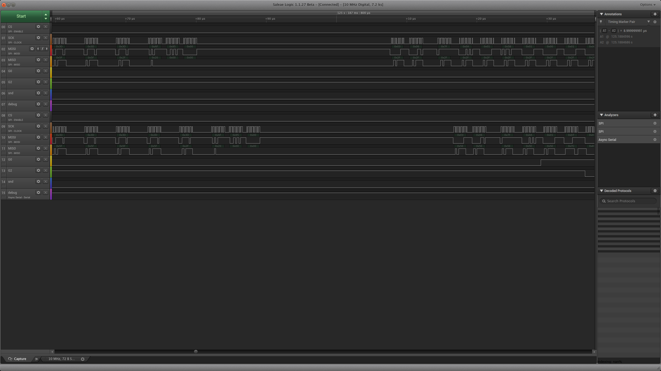

Here is another picture showing strange radio statuses if TXFIFO is filled (being in the wrong state), notice that G2 goes low:
After that radio is in TX_FIFO_ERR state. Firstly radio is put back to IDLE and then FIFO is flushed with SFTX:
The problem is that G2 pin indicating CARRIER_SENSE_VALID never goes high again after this issue therefore cca function does not work anymore. What should I do handle this error correctly?
NB: writing this post I realized that SFTX and SFRX can be called immediately if XX_FIFO_ERR state is detected, I issued SIDLE before those commands maybe this is incorrect?
