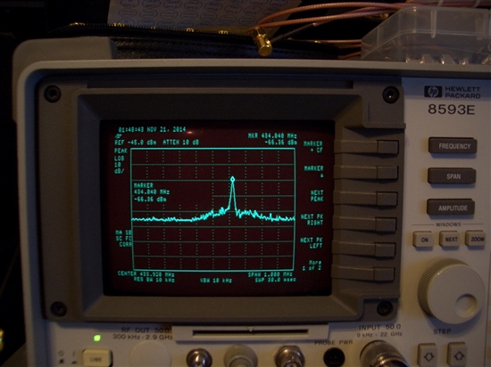

  • I am using a spectrum analyzer to monitor for RF at 433.92MHz with a 1 MHz span and 30mS sweep rate.  I am reasonably sure the CC1101 is not transmitting.
    I added a long delay after sending the TX strobe before initiating the next packet transmission.  I also write 0x06 to address 0x02 so GDO0 is set up to assert when sync word has been sent.  Upon writing the data to the FIFO and writing the strobe to address 0x35, GSO0 goes high exactly at the same time as when CS goes high.  My logic analyzer has about 1nS resolution.  This seems unlikely. Shouldn't there be some delay?

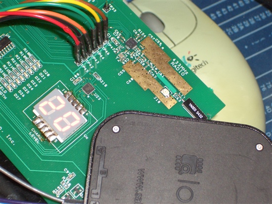

  • I am using my own hardware as shown here:
    The bottom layer of the PCB is solid ground plane.  The logic analyzer confirms I'm writing and reading the registers correctly in the CC1101.
    My logic analyzer shows a 434.05MHz transmitter over on the other side of my house that is transmitting as expected so I believe my analyzer is working.
    I feel like I'm not initializing the CC1101 correctly, or perhaps there is another step to making it transmit that I'm leaving out of my code.  I have not found any app notes that talk about transmitting packets beyond the CC1101 datasheet.
    Do you have an email address you would be willing to share and I could send you my source code project?

  • Hi
    What you are using is a spectrum analyzer. What I was asking is if you have a logic analyzer so that you can monitor your SPI traffic. A plot of you init routine would be nice to confirm that your SPI is OK. Have you tested to write registers and then read them back? Have you read the MARCSTATE register after strobing STX to confirm that the radio is in the correct state?
    The code example I sent you yesterday contains all the necessary steps to get the radio to transmit.
    • Init MCU
    • Reset radio (use the manual reset sequence as described in the data sheet and also used in the code example)
    • Configure radio with settings from SmartRF Studio
    • Strobe STX
    For testing you do not need to write any data to the TXFIFO. Simply strobe STX with an empty FIFO and the radio will transmit preamble until you fill the FIFO or issue an IDLE strobe.
    From a HW perspective, a picture of the HW is not telling me much. Have you followed our reference design when making your HW? Can you share your design files?

  • Are you measuring conducted or radiated? If radiated, do it conducted. Do you know if your board works as expected from a RF perspective? Eq try to connect the radio to the CCDebugger and do some initial testing with SmartRF Studio, now it could be that you have issues both with hardware and software.
  • Thanks for your response.
    I'm bringing up a second board now to try to rule out the hardware.  Will also try direct connection to the analyzer instead of using the antenna.
