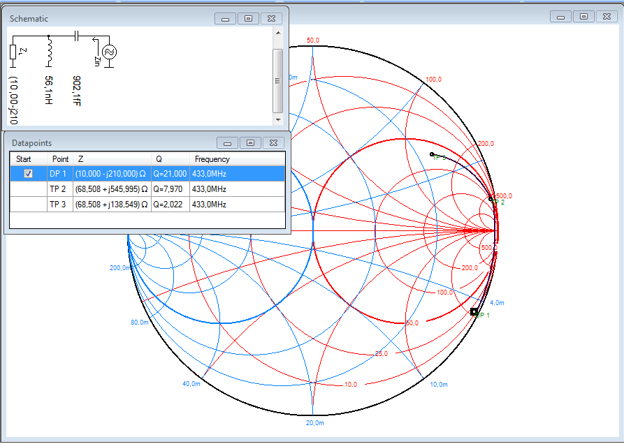

I design matching circuit for 433 MHz helical PCB antenna (13 turns) used in reference design (swrr081). I can find only documents which report impedance for 868 MHz helical PCB antenna, but not for 433 MHz.
Maybe someone have measured impedance? Can you provide me this number?
