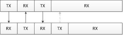

    If you are using TXOFF_MODE = RX and RXOFF_MODE = TX and try to send packets back and forth this will fail as soon as one packet is missed. See figure below:
    When a packet is not received by unit A it will be stuck in RX, Unit B, sending the packet that was lost, will enter RX and be stuck since no packet is sent from A (which also is stuck).
    The only way to get this to work is to have an RX timeout on both units timing out at the same time as a packet has been received, and which takes the radio into TX again.
