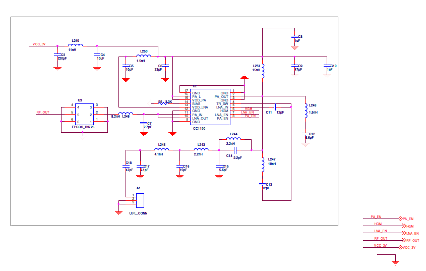

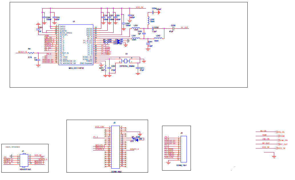

we designed Two custom boards with Ti reference Design.
One Board is designed with the reference of CC1110EM 868 and 915MHz Reference Design
and Second Board is Designed with the combination of CC1110-CC1190 wih reference of CC1101-CC1190EM 869 MHz Reference Design
please find the attached second board design schematics file1 & 2.

1) is there any mistakes we followed with reference designs ?
2) How we can achieve the distance more than 500 meters in LOS with our custom boards ?

    But when i connect one our range extender custom board to PC using CC debugger after when i open Smart RF studio panel it is showing detected CC1110 IC but when i enter into a control panel I am unable to select range Extender CC1190 to select the frequency range and for setting the power levels.

    2)CC1101 is a transceiver and CC1110 is an MCU, is there any schematic change do we need to do, if we combine CC1110+CC1190 with reference of CC1101+CC1190 ?

    When starting to debug you need to know if it's the transmitter or the receiver (or both) that have poor performance. Have you checked that the control signals for CC1190 is set correctly?

    2) No. It should be to replace CC1101 with CC1110. I haven't double checked the component values in your schematic but it looks correct.
