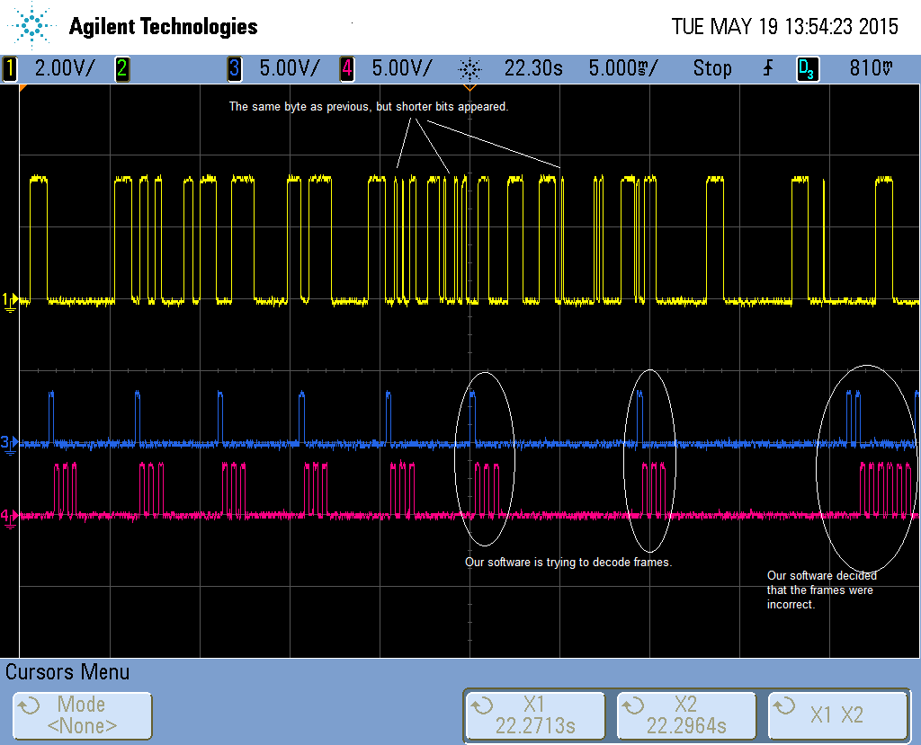

We are using CC1101 with MSP430F5xxx to communicate with “strange” device. We send a question and the device sends a response. It is always the same question, and the answer also should be the same. But randomly we receive incorrect data. On oscilloscope it looks like additional bit/bits appears in receiving frames. They don’t look like glitches nor jitters – just shorter bits.
We work on 433MHz; use asynchronous serial mode; 2,4kbd; RX filter BW=200kHz; 2-FSK modulation; deviation 6,3kHz. Below all our register settings.
We have another transceiver which work properly all the time and that’s why we assume that “strange” device always responses in the same way. We have tried many other registers settings, used another CC1101 module, antennas, tried to incorporate pull-ups, pull-downs and RC filters on uart lines and a few other things, but with no luck. And we don’t know what to do else.

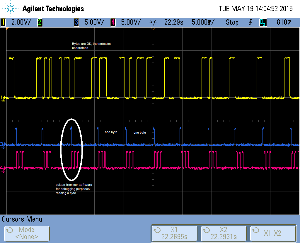

  • Could you please post some scope plots of a correct and a faulty frame showing the incorrect bits?
    There are two plots below: upper plot with correct bytes and lower plot with incorrect bytes.
    And the second plot with additional bits:
    Next bytes are ok, without additional bits or any other incorrectness.
