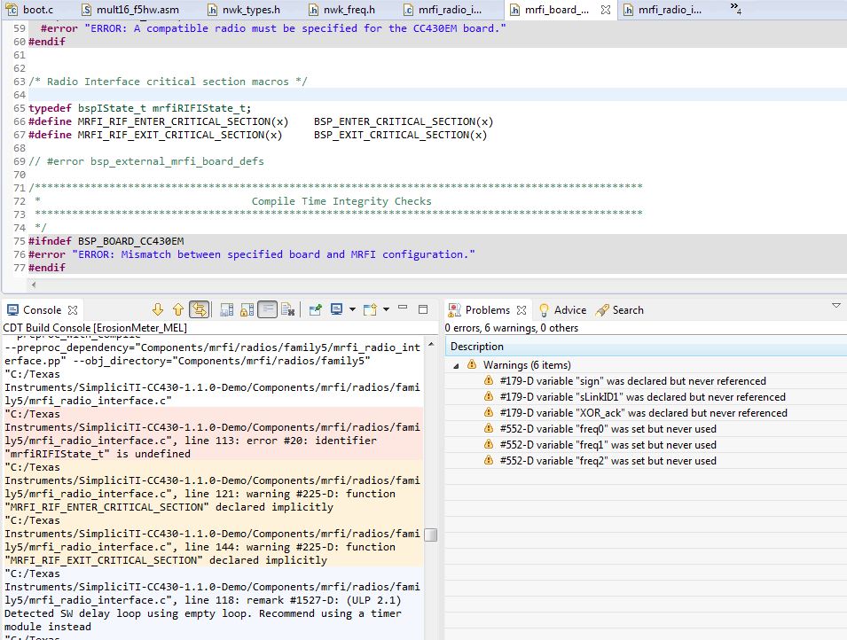

mrfiRIFIState_t undefined compile silent failure SimpliciTI
Other Parts Discussed in Thread: CC1101, SIMPLICITI, CC430F5137
Post from five years ago address what I think is a similar problem, but the link to the solution is now dead.
The underlying problem is my need to fine tune the CC1101 radio module embedded in the CC430F5137 uC. The radio registers are not directly visible in CCS or to any user software. Radio register access is via the "radio interface" and rather than roll-my-own I want to used "canned" routines from the SimpliciTI API. HOWEVER, try as I might, I cannot get the code to compile.

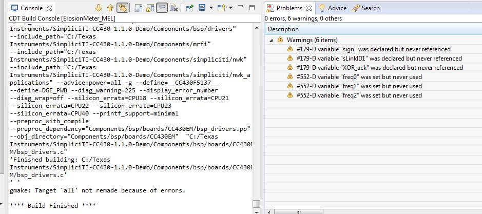

First attempts result in the "silent" failure (nothing appears in problem window) with the message in the console window (see below):
gmake: Target 'all' not remade because of errors.
Scrolling the console window locates the following:
Using CCS's navigate function I located the lines in Components/bsp/boards/CC430EM/bsp_external/mrfi_boards_def.h
* Radio Selection
#if (!defined MRFI_CC430)
#error "ERROR: A compatible radio must be specified for the CC430EM board."
#endif
/* Radio Interface critical section macros */
typedef bspIState_t mrfiRIFIState_t;
#define MRFI_RIF_ENTER_CRITICAL_SECTION(x) BSP_ENTER_CRITICAL_SECTION(x)
#define MRFI_RIF_EXIT_CRITICAL_SECTION(x) BSP_EXIT_CRITICAL_SECTION(x)
// #error bsp_external_mrfi_board_defs
* Compile Time Integrity Checks
#ifndef BSP_BOARD_CC430EM
#error "ERROR: Mismatch between specified board and MRFI configuration."
#endif
I tested the compile "thread" with the (now commented out) line:
The compiler definitely passes through this file.
I tried cutting and pasting the three "Radio Interface critical section macros":
into the mrfi_radio_interface.h file to have them visible in mrfi_radio_interface.c, but this didn't remove the errors. I even tried both places which result in numerous redefinition errors.
What do I need to do to achieve a successful compilation?

  • typedefs are nested and the end of the "chain" is the token __bsp_ISTATE_T__ which is dangling. In the file bsp_msp430_defs.h are the lines:
    #define __bsp_ISTATE_T__ unsigned short
    #define __bsp_ISTATE_T__ istate_t
    that are inside #ifdef <> for compiler/environment selection.
    Moving each of these lines outside the grayed out sections DOES NOT result in a successful compilation.
    In the first case CCSv6 complains that mrfiRIFIState_t is undefined, in the second case it's still undefined and istate_t is undefined.
    Aaaggghhhh !!!! I need this stuff to work!

  • Leo, after much futzing I was able to get the code to compile and link. I removed the five occurrences of the typedef defined variable (typically <s>) with the line:
    unsigned short s; // was mrfiRIFIState_t
    This got me over the hump. Linking was also a problem, but after multiple attempts I created a working set of files.
    I got into this because I couldn't establish an RF link between a TI experimenter's PWB and my custom PWB. Using an RF spectrum analyzer I determined the correction needed in the CC1101's frequency synthesizer and wanted to poke the values into FREQ[210]. I need the calls in mrfi_radio_interface.c to work.
    The link is still not robust--even after opening up the receiver bandwidth (RX BW) considerably--from the default 58kHz to 162.5kHz. Sometimes it works, sometimes not.
    My best guess is a parasitic oscillation in the receiver on my custom PWB. I made an attempt to squelch the oscillation, but the performance is marginal. I've asked for feedback from TI on this, but none seen as of yet.
    If time permits, I'll try adding your code.
    DE
