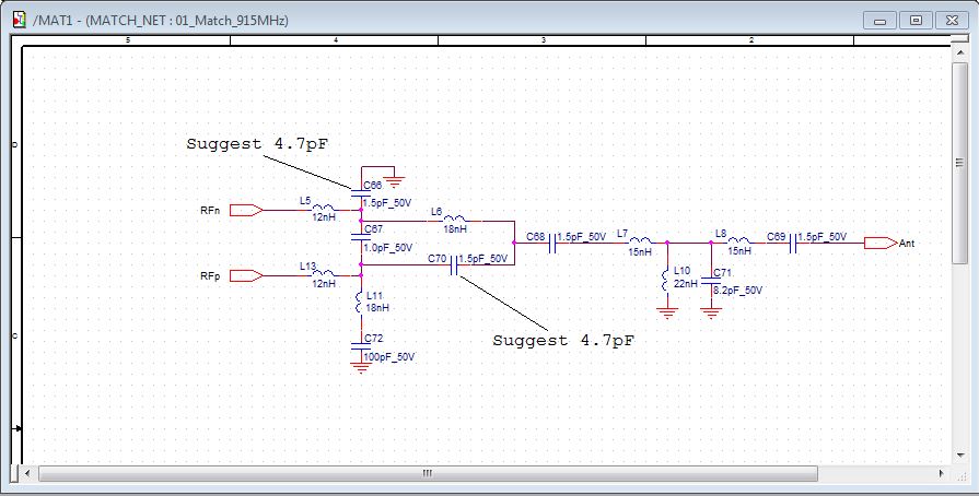

In a SPICE simulation of the balun and matching network, capacitors C66 and C70 provide control of out-of-band response and I replaced these 1.5pF caps with 4.7pF parts. See below.
The RF link now works. However, I still need to open the RX Filter BW to roughly three times the tool (SmartRF Studio 7) recommended value (on the RX side of this unidirectional link). I'm speculating that there might still be a low level oscillation. A sniffer probe on the spectrum analyzer might show this . . .

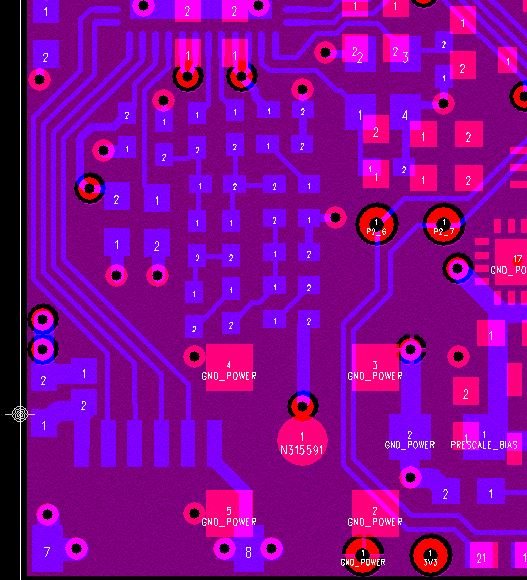

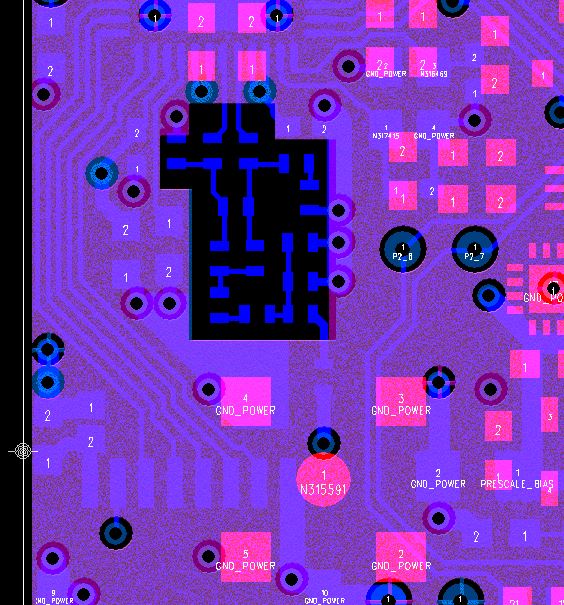

    Attached are JPGs of the old and new layouts. Care to critique? I opened the BOTH interlayers on the new layout of this 12-28-12 stackup (the two metal clad 12mil faces are adhered with a 28mil core).
    DE
    The old (currently in use) layout:
    The new spin:
    The largest concern with the first layout is there is a large risk of cross talk between the discrete components so the filtering and matching could be effected. This looks better in the new spin version. Do you have any GND plane underneath these components ?

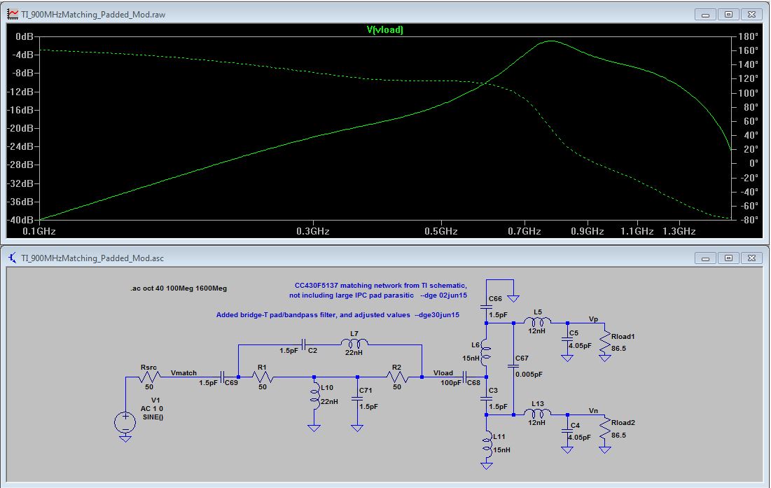

  • Richard, thanks for the reply. I think the new layout is better with the ground planes opened up.
    I fired up SPICE and designed the network below. I placed a bridge-T (lossy) matching network between the antenna and the balun. I realize I'm throwing away power with the bridge-T network, but I find that my Tx/Rx is much better behaved--it links immediately and the range is 20 fold when compared to the earlier version with the 4.7pF caps--a change I found necessary to make the link work at all. See earlier posts on squelching oscillation. I restricted my component values to those previously recommended by TI. In the new network, C67 is only a placeholder, it was removed. C2 bridging the 50ohm resistors was stood on end and L7 soldered to the free end. A #34 wire connects L7 to the far end of R2.
    With this change I can continue development without immediately spinning the layout.
  • P.S. The value to the right of L5 and L13 are used to simulated the impedance of the TI CC1101 module. They are not part of the external network. Not shown is C72, the DC blocking capacitor on L11. It's needed so the TI module biases correctly.
