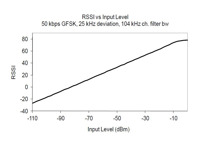

Is there any variability data for RSSI of CC1200?
The variability will affect the communication distance; therefore my customer wants to use the data for the designing.
