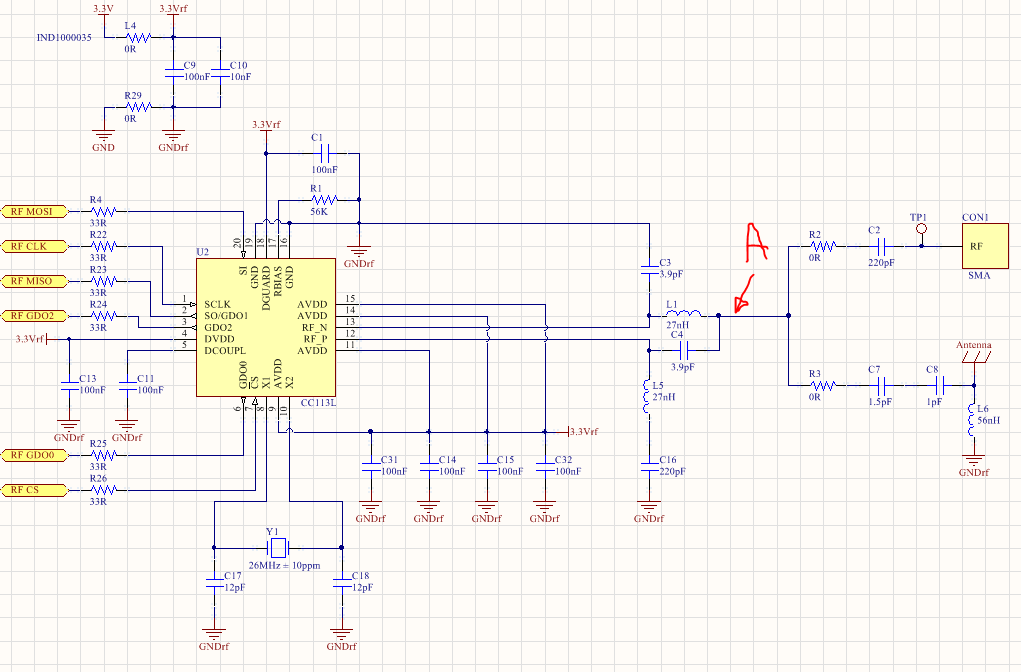

Hi All,
I am implementing the Balun @ 433.92MHz for the CC113L as per the values used in the reference design.
As per DN17 there is the following sentence "The balun in the 315 and 433 MHz reference design are not matched to 50 Ohm, it is only the antenna output which is matched to 50 Ohm in these designs."
Can someone supply the balun unballanced impedance (at the balun output) so I can verify my design.
Byron
