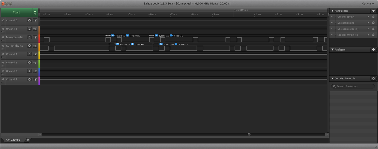

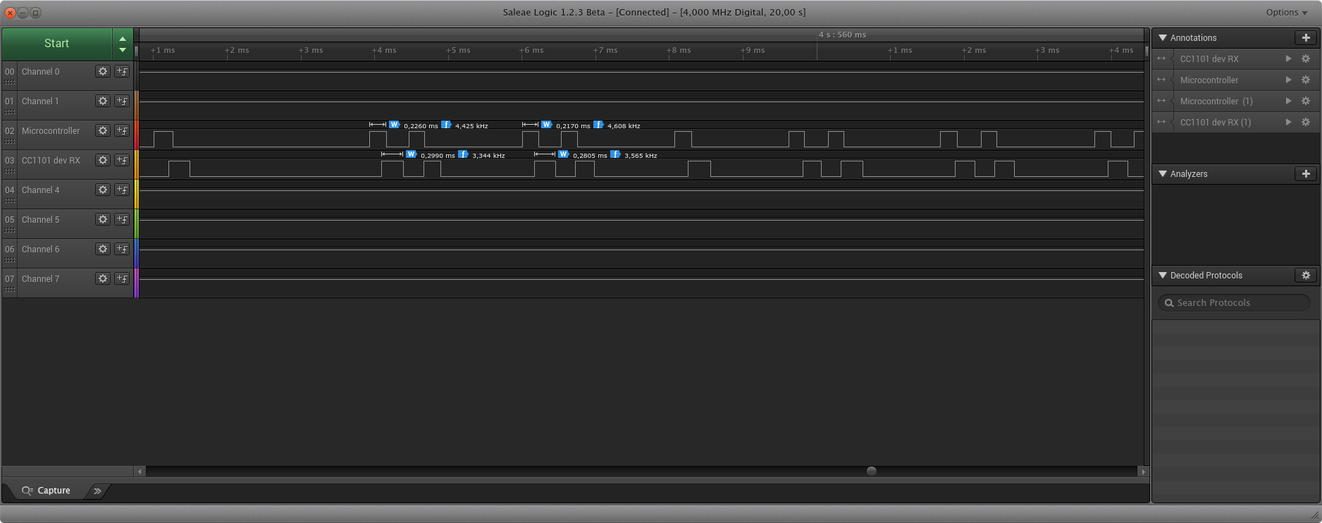

    We are using the CC1101 as a generic receiver as well as a generic transmitter. We therefore chose to use the asynchronous serial mode for both rx and tx. Both the GD0 and GD02 pins are connected to an microcontroller. Both mcu gpio's are timer gpio's. The tx timer generates arbitrary signals while the rx gpio captures received signals both coming from the CC1101.
    Lets take a look at the pictures in the attachment:
    This is a print screen taken from a logic analyzer.
    - The Microcontroller measurement (channel 3) represents the direct tx output to the GD0 input of the CC1101 (in TX mode)
    -  The CC1101 dev RX measurement (channel 4) represents the direct rx from the GDO2 output of the  CC1101 dev kit's  (in RX Mode).
    Both CC1101's uses the same configuration. Although, 1 CC1101 is in asynchronous tx and the other is in asynchronous rx.
    As you can see, there is a significant deviation between both signals. The ideal situation would be that the microcontroller measurement is exactly the same as the CC1101 dev RX measurement. Is there anything in my configuration that you can find below that i can tweak to make this performance better?
    I've tried multiple distances, but it doesnt make any difference. i also mentioned that the CC1101 randomly has noise when rx'ing. This probably has something to do with the surrounding noise.

  • Sorry, this ended a bit too far down in my mailbox.
    It is a given delay both through the Rx and Tx chain in CC1101. From the moment you apply a signal to the GDO pin there will be some delay due to the propagation through logic etc before the signal is sent from the antenna. The same in Rx, it will be some delay through the Rx chain due to filtering and ADC delay. If I don't misunderstand your plots it's what you are seeing.
