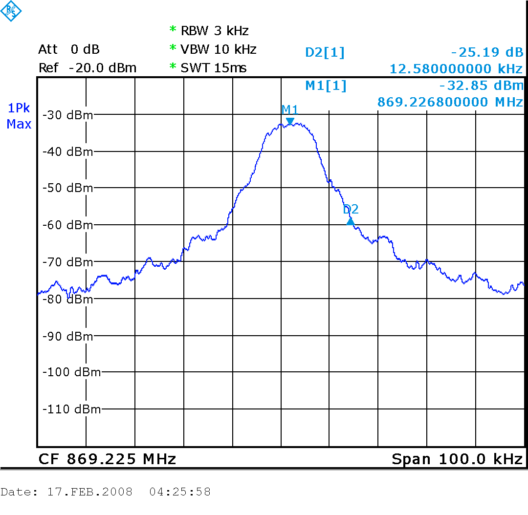

We have an idea to use CC430F5137 SoC with CC1101 radio chip in social alarm frequency band 869.20-869.25 MHz. Channel spacing according to EN300-220-1 is 25kHz.
Symbol rate will be 9600bps. 2-GFSK modulation, deviation 3,25kHz. We use a receiver based on CC1120 with RX filter BW 20kHz.
Currently we are using CC1120 transmitter in this band and we have already certified products with it. But we want to know if CC1101 will be as good as CC1120.
Will it be possible to pass certification (EN300-220) for transmitter with CC1101? The most interesting part will be to know about ACP.
