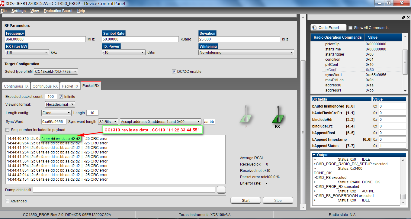

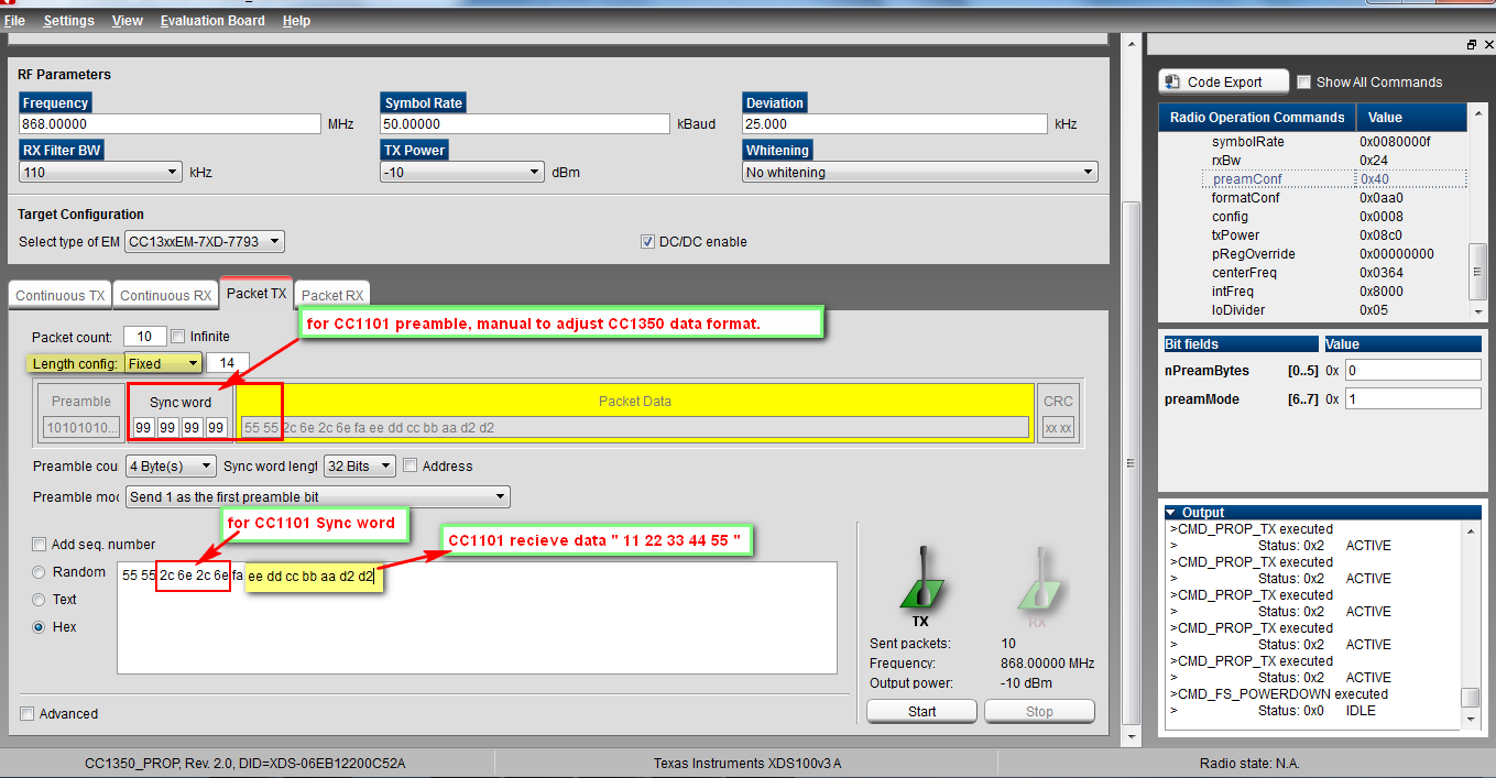

CC1101 Preamble& SyncWord are used Manchester encode, but CC1310 is no.
I manual to adjust CC1310 data format to send data to CC1101
CC1310 TX, I set preamble 0byte , Sync word manua to set manchester code.

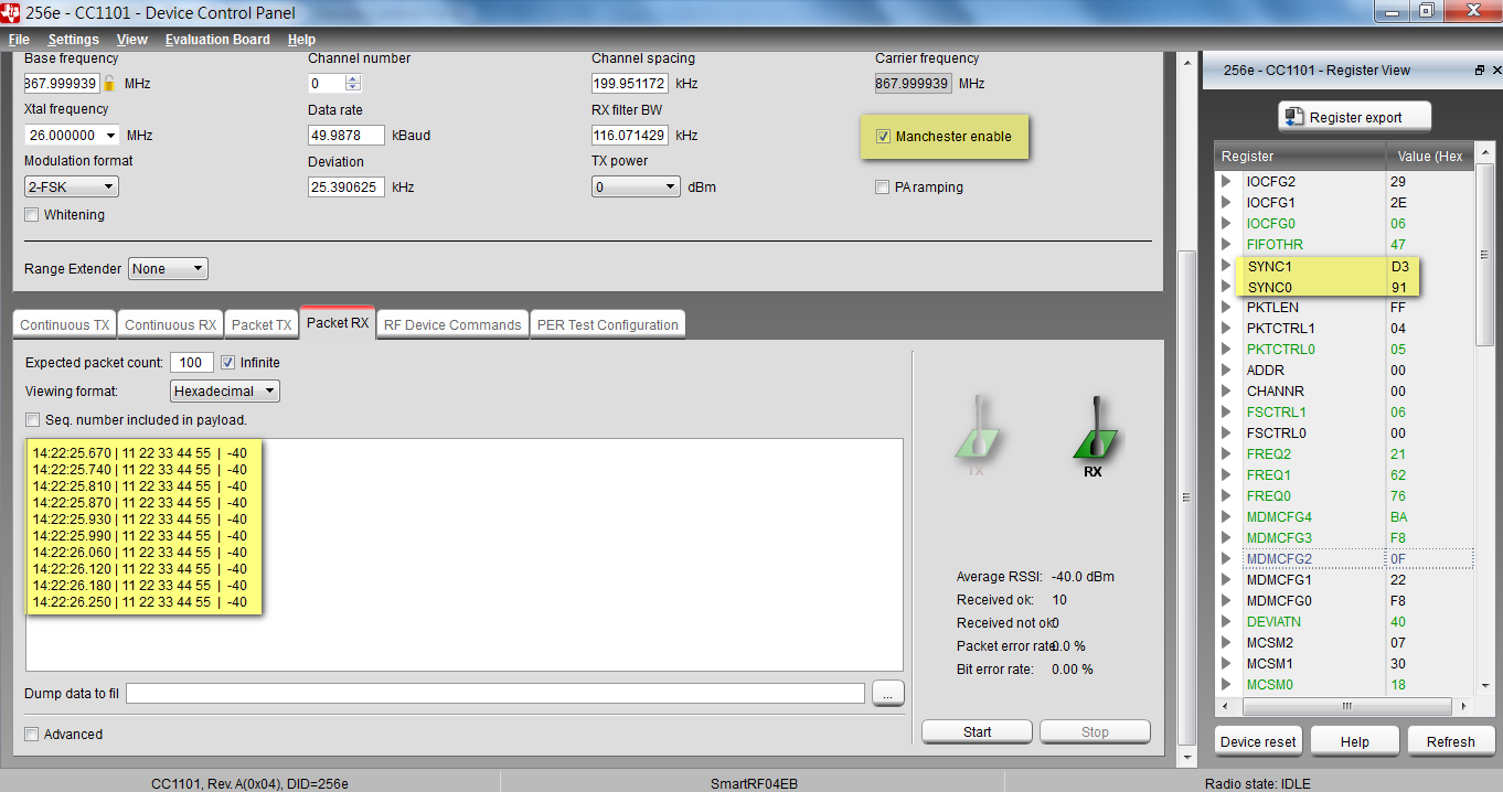

CC1101 RX
CC1310 RX:

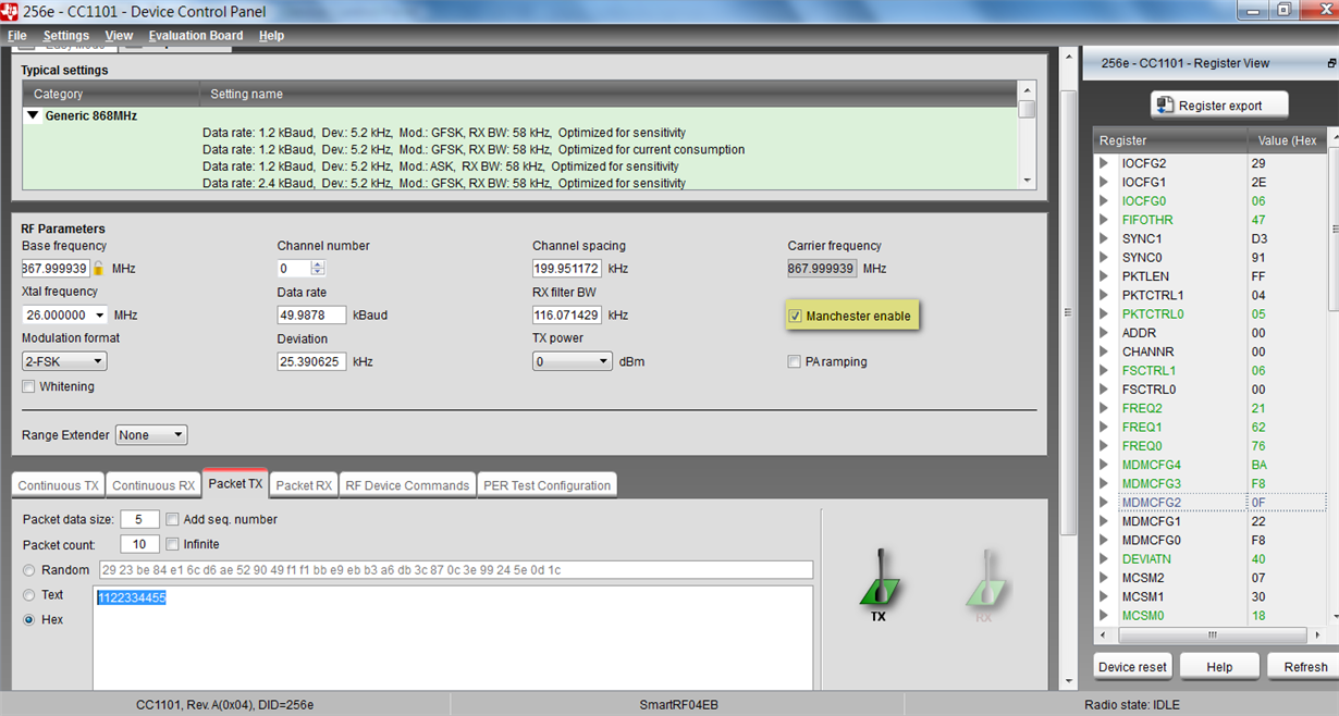

CC1101 TX

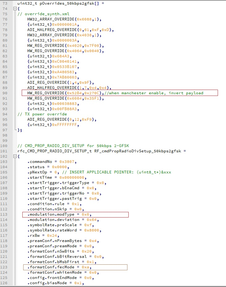

  • To turn on manchester coding when using (G)FSK:
    CMD_PROP_RADIO_DIV_SETUP.formatConf.fecMode=0xA
    With this the payload will be inverted. On way to fix this is to:
    CMD_PROP_RADIO_DIV_SETUP.formatConf.bBitReversal=1. This will invert both preamble, sync and payload so to be able to receive the sync word has to be inverted. Eq using 0x930B on the Tx side, the CC1310 sync word has to be set to 0x6CF4. The following override invert only the payload: HW_REG_OVERRIDE(0x52B4,0x270C)

  • 1) Since CC1101 sends a sync word using manchester coding. What you need to do on the CC1310 side is to program a sync word that is the manchester decoded version of the CC1101 sync word. If you are able to, use 2 byte sync on the CC1101 side.
    2) The override I sent can be included in the override list SmartRF Studio generates (pOverrides[]) before the 0xFFFFFFFF end overrides delimit. An override is basically a register write but since not all registers are possible to access directly or have a different meaning dependent on which mode the radio is in the values are provided in a bit cryptic manner to avoid writing to something that should not be written to.

  • I assumed the the CC1101 side is fixed. Then you can do the other thing I suggested: What you need to do on the CC1310 side is to program a sync word that is the manchester decoded version of the CC1101 sync word.

  • CC1101 does manchester like the following:
    Logic '0' = Low to High transition
    Logic '1' = High to Low transition
    The default CC1101 sync word 0xD391. Given that I haven't typed something wrong this is equal to 0xA65A9656 manchester coded. Eq if you want to receive a sync word sent by CC1101 using manchester you need to use 0xA65A9656 as the sync word on CC1310. The preamble is normally only used to settle the AGC, CC1310 will have no problems with a manchester coded preamble.

    We use Manchester encode : pOverrides--> HW_REG_OVERRIDE(0x52B4,0x270C) & formatConf.fecMode = 0xa

    I modified ”.fecMode=0xa” & ”.modulation.modType=0x0” . They still work abnormal.
