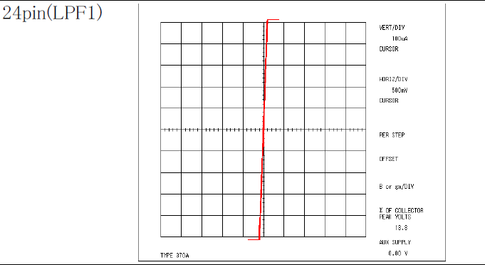

Have you ever seen the phenomenon to be broken the LPF1 pin on CC1121?
Our customer said that CC1121 was broken by repeat with replacing a battery work of system. So, we confirmed whether this device was broken, it was damaged the LPF1.  If possible, would you please show us the assumed cause?
If you have any questions, please let me know.

  • Hi,How did they determine LPF1 was broken?
    Was it a electrical failure or a physical damage?Thanks,PM
    We measured the electrical specification of between the pins. As a result, it seem that those devices were shorted to GND by electrical failure because there was not a physical damage on those devices by checking the package.

  • - Why did you suspect a failure in the first place?
    - Have you checked the impedance on a working part?
    I find it unlikely that the LPF1 pin is damaged since this is only connected to a cap.

    Their system did not work. So they checked whether the MCU confirmed that there was a response from CC1121. But there was not any responses from CC1121.  So, we checked the electrical specification of between the pins by using curve tracer. I attached the result as below.

  • - Is the voltage on the DCPL pins 1.8 V?
    - Is the voltage on the RBIAS pin 1.2 V?
    They are on the right track debugging wise. They should measure the impedance to ground from all pins for both a working an not working chip and see if the impedance on the not working sample is different from the working one.
