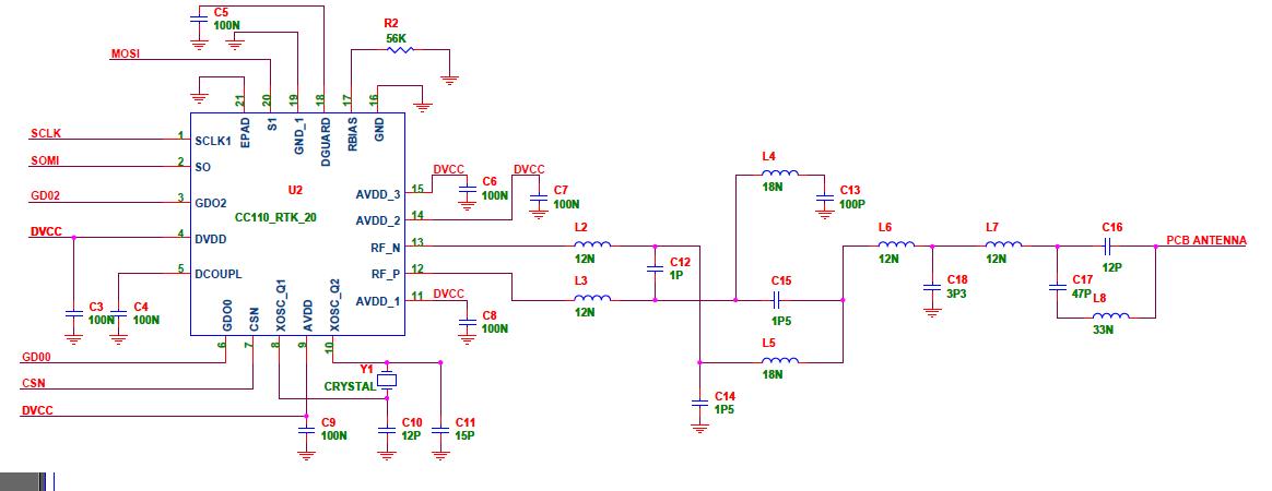

i am working on interfacing CC110L to G2553 and i am able to get GDO2 interrupt but not GDO0 and it is stuck @0.8V and i am easylink code and i dont know where i done mistake. please help me to resolve this issue.
Nandish
If the GDO0 is actually stuck at 0.8 V it sounds like either you have two outputs trying to drive the same pin or a hardware error. Please check how this is connected. Also try to disconnect GDO0 from everything else and see if you get the expected voltage values then.
