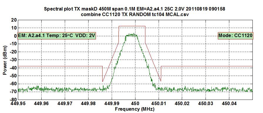

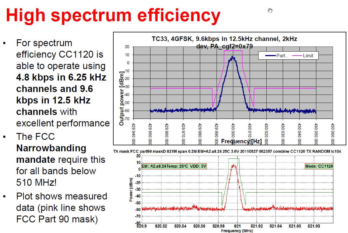

HI, I am looking at using CC1125 or CC1175 in design for radio to meet ETSI 300-113. I am concerned with adjacent channel power (> = -60dBc)  and have recently found a TI presentation on LPRF (from 2011) showing spectral plot for CC1120 in narrow band (12.5KHz channel) transmit at 9K6bps 4GFSK.
What setup was used to capture the spectral plot, (ie instrument name and type) and what were the settings used (video and resolution bandwidths etc) and how was the C1120 set up.?.
Having obtained a set of evaluation modules and RFStudio I would like to replicate the test.
