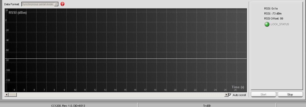

I have a question for the CC1200 AGC_CFG1 setting.
CC1200 is input -73dBm unmodulated signal.
When AGC_CFG1 is set to 0x51, the read RSSI is stable.

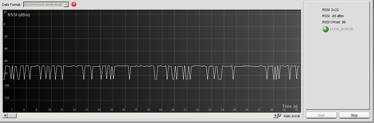

However, when AGC_CFG1 is set to 0x40 (AGC_WIN_SIZE and AGC_SETTLE_WAIT are 0), the read RSSI is not stable.
Please let me know why the read RSSI is not stable when AGC_CFG1 is set to 0x40.

  • - Could you provide the settings as a SmartRF Studio cfg file? Which setting did you start from? The register values looks like a mix of several.
    - I did a test with AGC_CFG1=0x40 with the standard 1.2 kbps setting in Studio and did not see an instability.
    Start from the 1.2 kbps setting but increase AGC_REF
