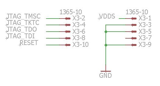

  • I have a custom board I just built with an CC1310 on board. I am using the sensortag debug devpack www.ti.com/.../cc-devpack-debug
    $15! to flash and debug with no problems.

  • This is the schematic at my 10pin JTAG connector. I think I have seen that subpath message before, I cant remember why now. I'll let you know if I see it again...
  • thanks for your post .it solved the problem with the devpack
    pin 1 on the TI devpack schematic has no connection to VDDS
    when I did it according your schematic it worked !
