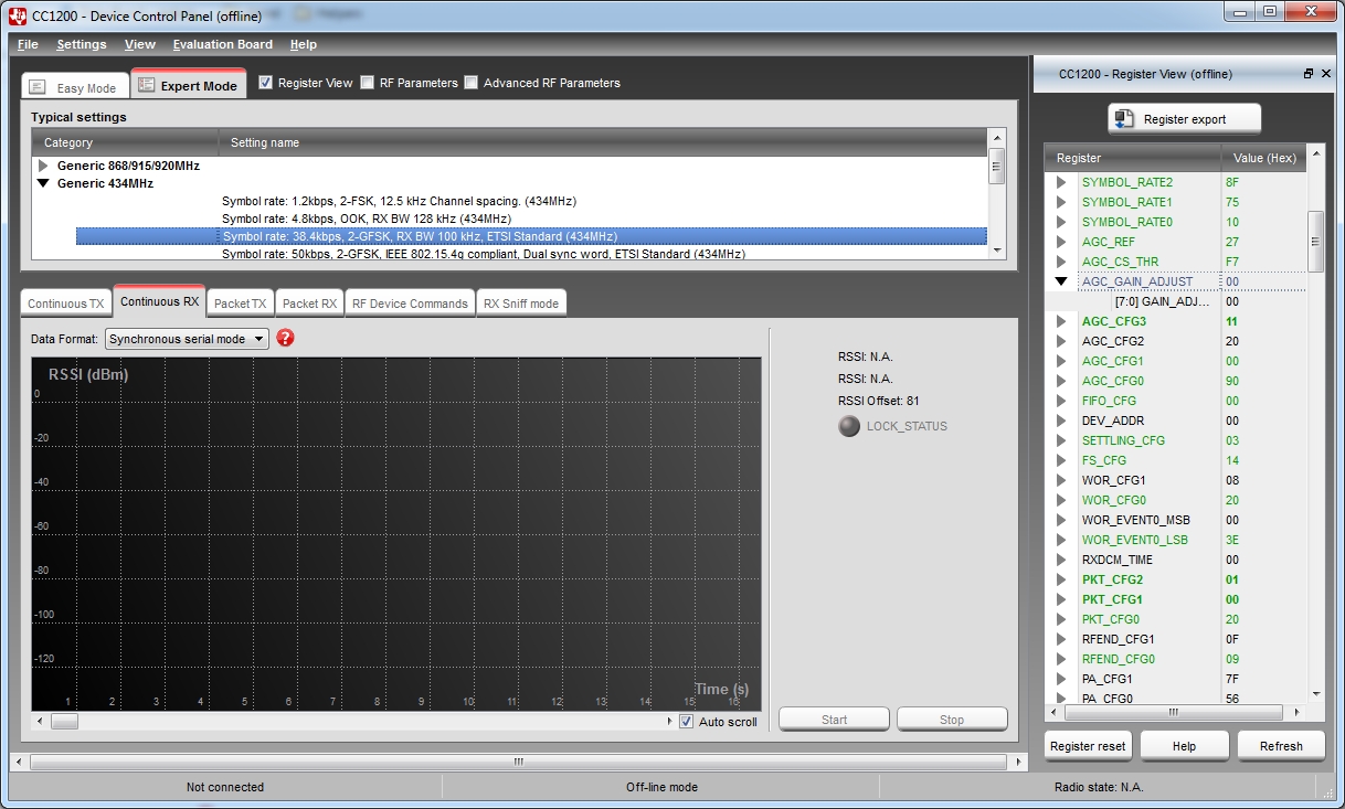

  • We took the CC1200 design from TI reference design. Does it mean that we expect to have same RSSI offset? When I should use 99 and when 81?
    I see in SmartRF that it shows 81 on the continues RX view but 00 on the gain offset register. Why 81 was selected?
    Thx for your help!!!
  • RSSI offset depends on the MDMCFG1.DVGA_GAIN setting. Examples from SmartRf Studio: For 1.2 kbps MDMCFG1.DVGA_GAIN = 0 and RSSI offset is 99. For 38.4 kbps MDMCFG1.DVGA_GAIN = 1 and RSSI offset is 81.
    In Studio the RSSI is calculated in SW as (RSSI reading from register - RSSI offset).
    If you want the CC1200 to handle the correction write 99 (or 81) decimal into AGC_GAIN_ADJUST. The RSSI reading will then be adjusted automatically so that the RSSI reading from register corresponds to the actual input power level.
    Please refer to the CC1200 User Guide (section RSSI)
  • Will the RSSI be adjusted also for the RSSI reported in the appended status data?
    Why Studio use the RSSI adjustment in software and not using the register offset (at least this is what I would expect)? Any drawbacks when using the RSSI offset in register?
  • Yes
    There are two ways of doing the adjustment; SW or through register. We used the former in Studio, but there are no drawbacks in using the latter.
