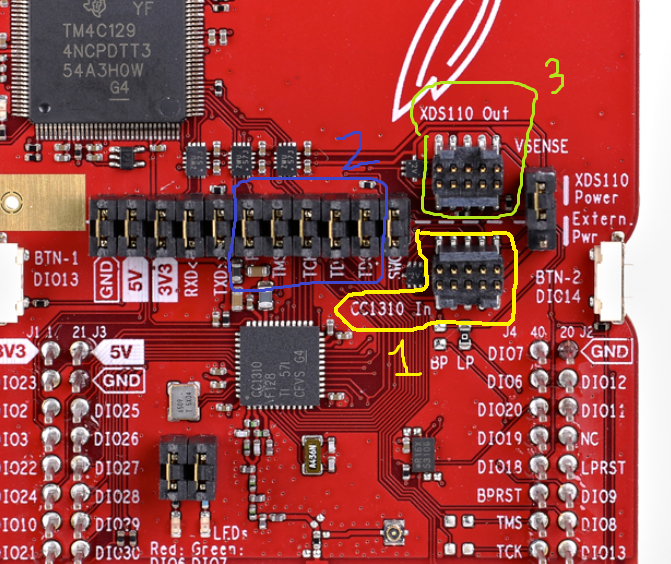

Can the supplied JTAG interface on the launchpad be used to program custom CC1310 applications, possibly even other TI (RF) targets?
I was looking at CC1310 Launchpad kit photo and I'm not sure where I can get JTAG pins out to program my custum board that has CC1310. I attached a photo:
I marked my guest. I think the most probable option is 2. I can disconnect the jumpers and put TDI TDO TCK TMS GND 3V3 in a connector and connect it in my custom board. Is it correct?
Thanks!
They use the new ARM recommended 10-pin header, just show a bit care when googling for the pinout (it led me to a wrong layout on my prototype).
If you google "10 pin jtag" the first result is this page from atmel, which I just cause I thought it was generic. Do not use this.
Rather use pinout in the pdf from second result in this google search:
You can also find the correct pinout from any of TIs reference designs which includes this programming header, for instance the SmartRF06
Edit: URL's acting a bit strange...
