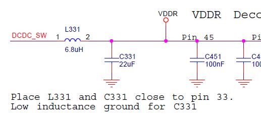

Team,
One of our customer are developing CC1310 module. They are asking if they can change inductance at DCDC_SW(L331) from 6.8uH to 10uH. The reason is they are an inductance manufacutring company but they don't have 6.8uH on their line-up. As far as I see CC2650EMK reference design, Inductance(L1) is 10uH but capacitor(C8) is 10uF and not same as CC13xx(CC13xx is 22uF(C331)).
<<<<<CC13xx reference design>>>>>
<<<<<CC2650 reference design>>>>>
CC2650 is same archtecture so I believe it should be no problem if customer follows same as CC2650EMK(10uH and 10uF).
Can I make sure if this change will not be any issue?
