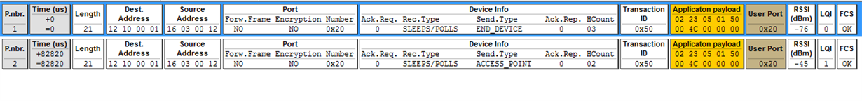

If I power the STAR1 network first everything links and joins perfect
If I power the STAR2 network first everything links and joins perfect
If I power the STAR1 and STAR2 network simultaneously then I see duplicate messages for the JOINING and LINKING
See image: " Duplicate messages RF Packet sniffer.png"
I can see that both AP1 and AP 2 is replying to a joining/linking device although only one has a valid JOIN and LINK TOKEN
Then when doing a poll I see that the AP2 is replying to ED1 polling messages but the addresses in the sniffing messages is still that of the STAR2 network, but I can see that it is AP2 replying to ED1 polling messages because if tI move the sniffer closer to AP2 the RSSI is stronger that when closer to AP1,
Close to AP1
Close to AP2
Why is the AP's replying to ED's that does not have it unique STAR JOIN/LINK TOKENS

  • Just for info for other guys that might encounter the same probple
    After much investigation I found that by setting
    MAX_HOPS_FROM_AP = 0
    MAX_HOPS = 0
    my problem was solved. It looks like the AP was acting as range extenders  and trying to hop messages to distant AP's will both AP's was in range causing. During Linking it seems like the AP's registered each other and thus causing multiple messages being forwarded.
    Is there any one at TI that can give me more insight to this problem that I encountered and why this is happening. Am I misunderstanding the concept of HOPS and AP's and RANGE_EXTENDERS.
