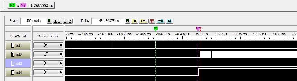

When the Task_sleep is commented out, as above, the system runs as expected - the task continuously executes, toggling LED_2. The timer interrupt happens every 1.67ms and pulses LED_3. See the logic analyzer capture below.
 Figure 1 - no task scheduling. The one and only task is constantly ready and executes as LED_2 shows The timer interrupt happens every 1.67ms as can be seen by observing LED_3.

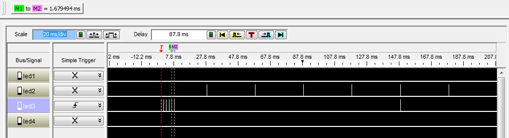

But the moment the Task_sleep is uncommented, the system starts working unexpectedly. The logic analyzer capture below shows the start of the program on the dev board.  For a few first milliseconds you can see the timer interrupts every 1.67ms and then they stop. From that moment on, the timer interrupt would still happen, albeit sporadically. See figure 3.  Strangely enough, the subsequent timer interrupts would always coincide with the time when the task wakes up.
Figure 2. - starting the application with RTOS switching.  The timer ISR runs for a short while but then breaks.

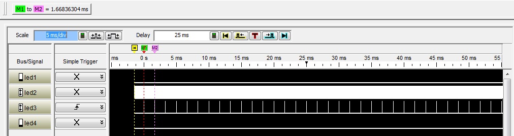

Figure 3 - the same trace as in figure 2, but zoomed out.
We suspect that there is a problem with TI-RTOS and would like to hear a comment from TI people.

    thank you very much for this excellent and detailed report.
    Three comments:
    1) The problem is that TI-RTOS does not know that standby is not allowed while the timer is running. Task_sleep() let the kernel enter standby mode because it assumes that nothing has to be done. Power_setDependency() just guarantees that the related power domain is switched on. It does not prevent the system from going to standby. What you need here, is an additional constraint Power_setConstraint(PowerCC26XX_SB_DISALLOW) in order to prevent from standby.
    2) A cleaner way of setting up a custom hardware interrupt handler is provided by the Hwi module in TI-RTOS. Here is an application source file where the interrupt is set up using Hwi and works as expected:

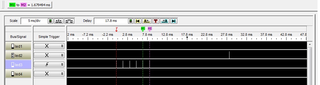

    even though the test code above started working fine, we are still experiencing issues with our actual project and even after we disabled the standby as you suggested.   It is possible that while trying to build a test case for you, I didn't really replicate all of the issues that caused our system to fail.
    My attempts to built another test project to demonstrate the failure that we see in our system didn't succeed. I hope that if I give you a verbal description you might be able to at least point me to where I should start looking more closely for an explanation.

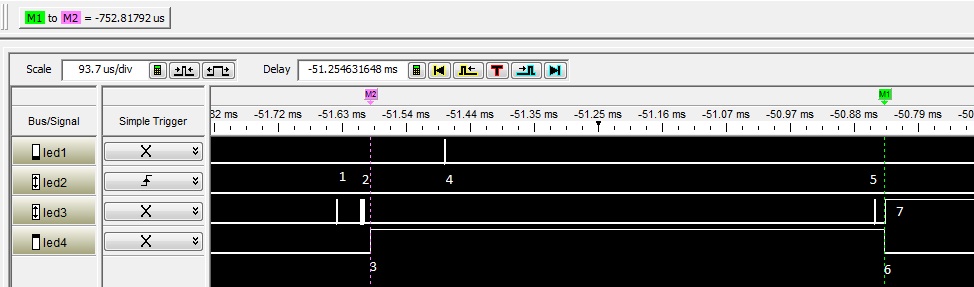

     So, as in the code above, we have a heartbeat task that sleeps for a period of time( in this case it is exactly 1.098 ms), increments a counter and goes back to sleep.  It also blinks an LED when the task wakes up.
     Another task is waiting for an event that is posted by the timer ISR.   There are actually two interrupts generated by the GPTM - the match interrupt and the timeout interrupt.  They are about 750us apart, with a period of say 50ms.  I am not sure if it is relevant.
    Each of these two interrupts posts its own event to the waiting task.
     On the first event the waiting task wakes up, does something (prepares data for transmission in our system) and starts waiting for the second event . Upon waking up on the second event it starts transmission, finishes it and goes for the wait for the first event again.
    It is a periodic process that happens every 50ms and I have LEDs that mark every event in this system.
     Here is the logic analyzer capture for it.

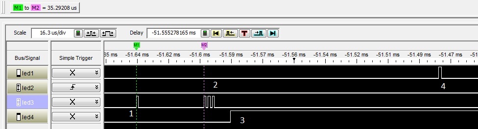

    In this capture, the LED1 - is when the heartbeat task wakes from sleep, every 1.098ms.
    LED3 shows interrupt activity and timing of the waiting task, as will be explained later.
    LED4 is the time when the waiting task is pending on the second event - start of transmission, as explained later.
    The capture below is a zoomed in fragment of activity.

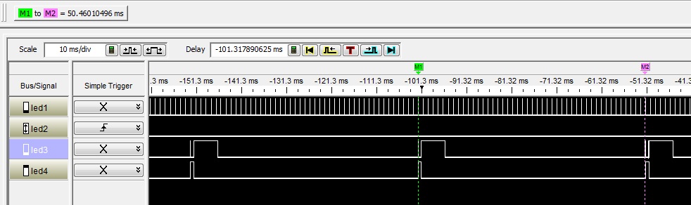

    The LED 3 captures interaction between timer ISR and the waiting task.  Will be explained in the expanded view later.
    LED4 is about 750 ms  - time the waiting task pends on the second event from the timer interrupt. Shown here for clarity only.
    This capture shows the complete interaction between ISRs and the waiting task. The time point labeled 1 is where the timer ISR happens, just before it sends the first event to the waiting task.  Time point 2 (actually comprised of three quick pulses of the LED3) is when the waiting task wakes up on the event and starts pending on the second event at time point 3 of the LED4.  There is about 30 usec switching time, which is about normal.
    Note the time point 4 - it is where the heartbeat task wakes up from its periodic sleep.  Because sys timer of the RTOS is not synchronized to the GPTM , the location of the heartbeat task wake up constantly changes relative to the waiting task activity.
     The time point 5 is when the second interrupt happens in the timer, posts an event to the waiting task which wakes up the waiting task at point 6 where the transmission starts at point 7.
    The capture below shows the detailed fragment of events 1-4.
    1 - Timer interrupt before it posts the first event. 2 - the waiting task woke up, 3 - the task started pending on the second event. 4 - the heartbeat task woke up and went back to sleep.
    This sequence breaks after a random time, minutes or hours. Below is what happens at that time.
    In this capture the error condition is detected, as indicated on LED2.  The capture below zooms in to the area.
    This is the most important capture.  The first pulse on the LED3 is when the first timer interrupt happened.  Please note that the heartbeat task wake up coincided with it - LED1. On the capture they are a few microseconds apart, meaning that the hardware interrupt from the GPTM likely happened in exactly same time as the RTOS sys timer interrupt did. The result of it is absolutely strange.
    The first event posted by the timer ISR arrives to the waiting task EXACTLY 1.098 ms after this, as can be seen above , upper left corner, in the M1 to M2 markers distance. Not in 30 usec, but in 1.098ms.  As if time stopped for the system for the duration of the heartbeat task waiting period.  And this is a problem.
    After the 1.098 ms delay the execution continues. The capture below is the zoomed area of that time.
    Three pulses at the time point 2 are where the waiting task woke up, point 3- where it starts waiting on the second event, 4 - the timer ISR happened, which was in a totally wrong time, and the system detected it and went to error condition as LED2 showed.
    We captured the same behavior many times. Every time when the system breaks we see the system timer interrupt, that woke up the heartbeat task, coincide with the GPTM interrupt.  And every time the system "freezes" for exactly the sleeping period of the heartbeat task.  If I configure the heartbeat to sleep for 3 millisecond, the error behavior will be the same, but system will freeze for 3 ms etc.
    I call it a "freeze" because this condition disables global interrupts, or at least the GPTM interrupt,  and blocks the waiting task for  exactly the period of the heartbeat task sleeping. I can't imagine a software error on our side that could explain this "cross contamination" and RTOS behavior.  A stack overflow could cause something like this, but we checked and eliminated this cause.
    Do you have any suggestions what it might be?
    Thank you,
    Sergey
