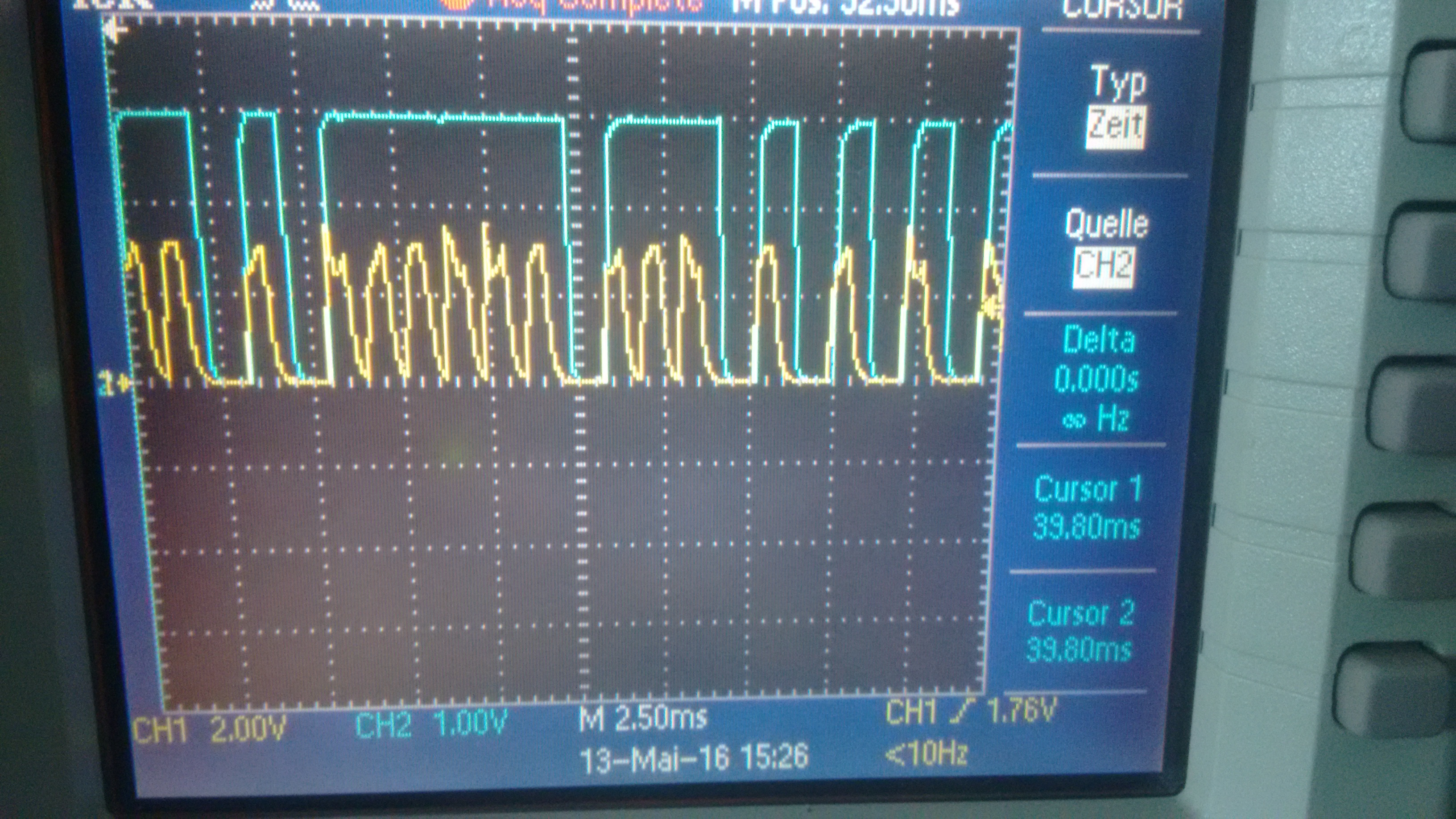

Hello, I wanted to ask how I can monitor or look up the tdc value on the CODE COMPOSER STUDIO below is the code I wrote in SCS.
and the jpeg I attached explains the use of the timer to read the length of the IR signal(yellow SIG the comparator output is the blue SIG) to determine which button was pressed on the remote control.
