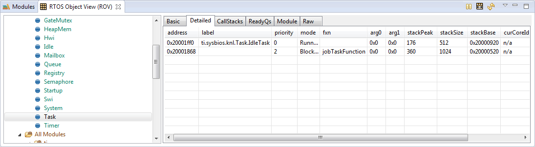

    sorry, I haven't had the time to replicate your setup, so I have to bother you with more questions. Let's first look at the most obvious things. Can you please find out:
    • What is happening when the program blocks? Does an exception occur? You can check that in the ROV viewer (Screenshot 1). Please also have a look into "BIOS" -> "Exceptions".
    • Or do you maybe observe a stack overflow? Check the stack peak vs the stack size for your task and for hwi.
    I guess that the SPI transaction is declared as global variable, isn't it.
