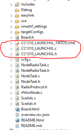

  • Not sure what you are trying to do. It looks like you are mixing files from the SDK and TI-RTOS 2.21. If you want to change the board files you only should have to remove the files I have ringed from build and replace with the board files for your packet size/ board

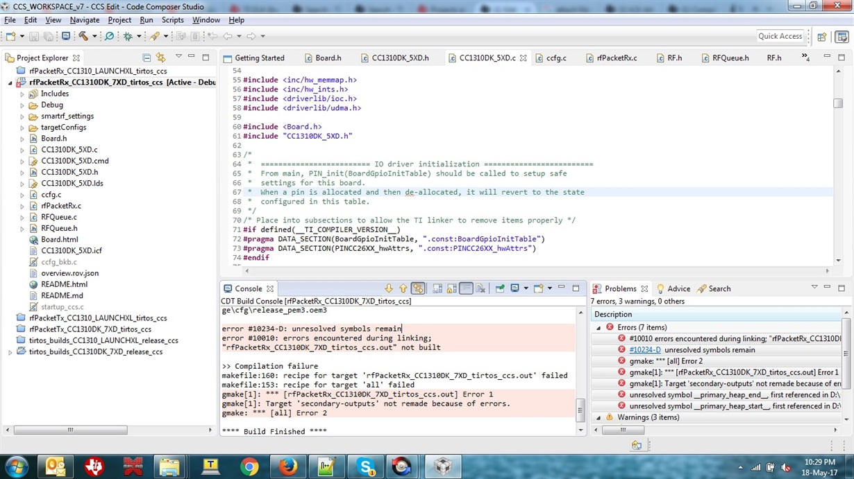

    I have already replaced the board files and removed other files. Below is the currrent setting of the workspace.And also attached the workspace. Please verify.
    rfPacketRx_CC1310DK_7XD_tirtos_ccs.zip
    The new error is given below.
     undefined              first referenced
      symbol                    in file
     __primary_heap_end__   D:\CCS_WORKSPACE_v7\tirtos_builds_CC1310DK_7XD_release_ccs\Debug\configPkg\package\cfg\release_pem3.oem3
     __primary_heap_start__ D:\CCS_WORKSPACE_v7\tirtos_builds_CC1310DK_7XD_release_ccs\Debug\configPkg\package\cfg\release_pem3.oem3
    error #10234-D: unresolved symbols remain
    error #10010: errors encountered during linking; "rfPacketRx_CC1310DK_7XD_tirtos_ccs.out" not built
    >> Compilation failure
    makefile:160: recipe for target 'rfPacketRx_CC1310DK_7XD_tirtos_ccs.out' failed
    makefile:153: recipe for target 'all' failed
    gmake[1]: *** [rfPacketRx_CC1310DK_7XD_tirtos_ccs.out] Error 1
    gmake[1]: Target 'secondary-outputs' not remade because of errors.
    gmake: *** [all] Error 2

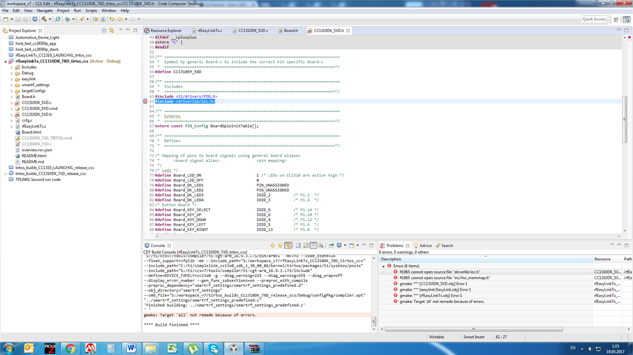

  • Hi, Ter
    Where is 5x5 chip support files inside folder C:\ti\simplelink_cc13x0_sdk_1_30_00_06?
    If I use 5x5  files from here e2e.ti.com/.../507505
    I'v got errors:

    I have changed all the paths in CC1310DK_5XD.c file. Even after changing all the paths i get below error.
    error #10010: errors encountered during linking; "rfPacketTx_CC1310DK_7XD_tirtos_ccs.out" not built
    gmake[1]: *** [rfPacketTx_CC1310DK_7XD_tirtos_ccs.out] Error 1
    >> Compilation failure
    makefile:159: recipe for target 'rfPacketTx_CC1310DK_7XD_tirtos_ccs.out' failed
    makefile:152: recipe for target 'all' failed
    Can you please suggest solution. I have attached updated source code.rfPacketTx_CC1310DK_7XD_tirtos_ccs-1.zip
