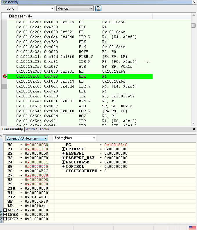

I find there is a ROM function for AES CCM decryption in SDK: AES_CCM_DecryptData.
But, my application get faults in this function call. Because, this function, AES_CCM_DecryptData, wants to jump to an invalid address.
The screenshot for my debug enviroment is attached.
Is there any inilizations required for this function call? Do I miss something for this function call?
Please let me know about that.
HH
    the function you mention is part of the internal driverlib implementation. We ship the CC1310 with a bunch of driverlib and TI-RTOS kernel functions already preprogrammed in ROM.
    TI-RTOS provides a high-level crypto driver. But if you want to use the AES hardware accelerator based on driverlib in a Ti-RTOS application, then you can use the following code snippet for inspiration:

    All AES-related functions are stored in ROM if you use driverlib in ROM.
  • Hi Richard
    These functions you mentioned, CRYPTOAesLoadKey/CRYPTOAesEcb, are NOT in ROM. No ROM address define for these function, and these functions are linked in flash.
