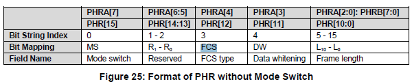

    What do I have to write in the TX FIFO when I use the 802.15.4g packet mode?
    Im not sure if it has something to do with PHRA and PHRB fields (CC1200 users guide page 55).
    Are they generated automatically or do I have to write them in the TX FIFO?

  • See 8.7.2.1 in the UserGuide, the application have to write the correct PHR field to the TX FIFO
  • Problem is that I dont really understand how to calculate PHR.
    If I want to write 6 Bytes of data I would understand the calculation table as follows:
    PHRA= 00010000(binary)
    PHRB= 00001000(binary)
    because:
    Mode switch -> PHRA[7]=0(binary),
    Reserved -> PHRA[6:5]=00(binary),
    FCS type -> PHRA[4]=1(binary), // if I understood it right, I can choose here wether FCS is 0 or 1 without consequences for simple radio functionality (not focused on optimizing range etc.)
    Data whitening -> PHRA[3]=0(binary),
    Frame length(= 8, PHRA + PHRB + 6 Data bytes) -> PHRA[2:0]=000(binary)
                                                                                             -> PHRB[7:0]=00001000(binary)
    Is this calculation right?
    In case its not: what did I wrong?
    I will start a new threat for the TX FIFO Error to seperate the problems.
  • Hi
    This calculation is right, but your assumtions is wrong. The reason is your assumption of the frame length. You set the frame length to be the data bytes + the PHR, but the spec states that the frame length is the length of the PSDU which includes the FCS. So depending on the uso of 4 or 2 byte FCS, the frame length will be eiter 8 of 10 in your example. The PHR bytes is not inclded in teh frame length.
