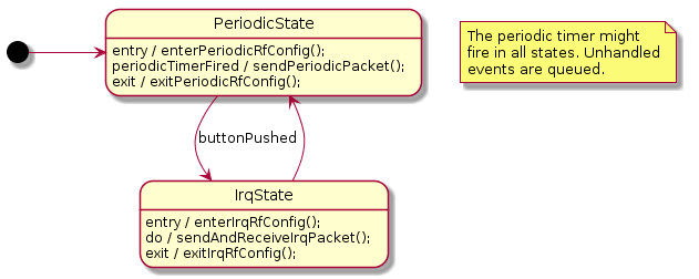

  • Guys, may I chime in here. I think that you over-complicate the problem.
    Although TI-RTOS supports multiple tasks, I generally do not recommend using more than one task if it doesn't add certain value to the application structure and readability. When you access easylink from multiple tasks, you have to treat it like a shared resource. That means: no double initialization, protect mutual access. You have done that already with semaphores.
    Instead, I would suggest to use a single task and implement a state machine that switches states based on events. The tool PlantUML comes in handy for drawing quick state and activity diagram sketches.
    Let's look at an example. An application sends a periodic packet, but from time to time, it needs to send a spontaneous packet with another RF configuration and wait for a acknowledgment reply. The state chart is very simple here as there are only two states incorporated:
    Diagram source code rendered on plantuml.com:
    @startuml
    state PeriodicState {
        PeriodicState : entry / enterPeriodicRfConfig();
        PeriodicState : periodicTimerFired / sendPeriodicPacket();
        PeriodicState : exit / exitPeriodicRfConfig();
    state IrqState {
        IrqState : entry / enterIrqRfConfig();
        IrqState : do / sendAndReceiveIrqPacket();
        IrqState : exit / exitIrqRfConfig();
    [*] -> PeriodicState
    PeriodicState --> IrqState : buttonPushed
    IrqState --> PeriodicState
    note "The periodic timer might\nfire in all states. Unhandled\nevents are queued." as N1
    @enduml
    In the application, the state machine is implemented in the following way:

    The application has only 1 task. This task encodes the state machine logic.
    State transitions are based on events only.
