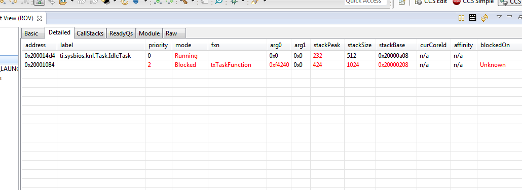

    I'm using the RF Packet TX and Pin interrupt examples to send a packet when a button interrupt the cc1310.
   I created a task for TX packet and a semaphore that activate the task when button has been pushed.
   The application work fine if i push the button frequently, but if i wait for some minutes the task blocked by unknown (in ROV). The button interrupt callback function executed correctly but the TXTask "blocked by unknown".
Why happend this?
   I use " Semaphore_pend(semTxHandle, BIOS_WAIT_FOREVER);" so the task could be waiting forever until a "Semaphore_post".
Best regards.
  • It sounds like a corruption problem. Can you do a "scan for errors..." in ROV->BIOS? Check it in main, right before you call the semaphore_pend, and in the button callback.
  • There is no errors when the code running before semaphore_pend or button callback, but there are some errors in the main before start debug.
    I'm using CC1310F32 instead CC1310F128:
    Error: Problem scanning pend Queue: JavaException: java.lang.Exception: Target memory read failed at address: 0xbebebebe, length: 8This read is at an INVALID address according to the application's section map. The application is likely either uninitialized or corrupt.
    Error: Problem fetching Task stack: Error: fetchArray called with length 0.
  • like the first message says, the application is either uninitialized or corrupt. Before you create the task and semaphore, you will get an error.
    If you start the application and pause it with the debugger, the ROV messages should disappear.
    Can you confirm this?
    Are you using events in your code? I've seen this message before "blocked by unknown" when using events. Just to be clear, your code doesn't work anymore after a few minutes? Or does still work but you see "blocked by unknown"?
  • Hi Michel,
    when i start the application and pause, the ROV messages disappear.
    I'm not using events in my code.
    When the application is running for some minutes, the task is "blocked by unknown" instead "blocked on Semaphore: 0x200012a0" and i can't restart the task.
  • Hi Jose,
    I am not too familiar with the CCS TI-RTOS environment since I've worked only with IAR but here are a few things that I've found that helped figure out the problem.
    The fact that it occurs only after some time makes it look like it was some data overflowing.
    If you look at the Task view in ROV, can you see all your tasks (or do some names disappear)? Check just after all tasks have been created, to see how much of the stack has been used for each task (any tasks close to their limit?). Then check after the program stops working, have any names disappeared? Does the data still make sense? If not, most likely, you have a stack overflow and try increasing the stack sizes.
    Another thing, once the program stops working, can you check what semTxHandle is pointing to? Is it still 0x200012a0? If not, it could mean that you have some free pointer changing variables in areas where it shouldn't.
    Give these a try and let us know what you come up with.
    Michel
  • Hi Michel,
      thanks for your comments but i did some changes and not solve my problem.
      First, I'm using CCS but i tested you said and the semTxHandle is pointing to 0x200012a0 everytime, when crashing too.

  • Hi Jose,
    Any update on this?
    Todd
  • Hi Jose,
    Could put your code in a text file because it does not show up on the forum?
    Could you also put sreen captures of the Task ROV (The module tab and detailed tab if possible) when the crash has occurred?
    Michel
  • Hi Michel,
       attach the code. If you have any DK or the Launchpad you can compile it and see that work for some minutes, but then the main task and interrupt run but the secondary task and semaphore do not run.
    Thanks!

  • Hi Michel,
       thanks for your comments. I did your first way (the second i dont like), remove CPUDelay from button callback and use Task_sleep inside the task but not solve the problem.
      Some minutes later the program is running, the task turn to "blocked" by unknown. Attach the picture. I think that the RTOS turn the uC to sleep or similar and the semaphore pointer lost...
  • Jose,
    First, I'd make the debounce semaphore binary instead of counting (semParams.mode = Semaphore_Mode_BINARY). You don't need a counting semaphore in this case.
    Second can you look at the call stack for the txTaskFunction? It's in ROV->Task->CallStacks. I'm wondering if you are blocking in the RF_runCmd function. You get blockedOn = "Unknown" in ROV if the the task is in Blocked mode and the item the task is blocking on not a Mailbox, GateMutex, GateMutexPri, Semaphore, Event or Task_sleep.
    Todd
  • Hi Todd,
       thanks for your advice. I found the problem. Blocked by "unknown" is RF_runCmd function.
       If i remove this code of the task function, not blocked by unknown:
    /* Send packet */
    RF_EventMask result = RF_runCmd(rfHandle, (RF_Op*)&RF_cmdPropTx, RF_PriorityNormal, NULL, 0);
    if (!(result & RF_EventLastCmdDone))
    //Error
    System_printf("Error RF_runCmd\n");
    //while(1);
    What can i do to send a  RF packet inside the task?
