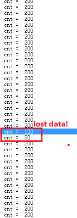

Is there anybody occurs such a problem: the uart will lost data or stuck after several minutes while receiving data?
I just made such a test: I transmit 200 data to the CC1310 UART through USB serial port every 1s; then  I made a timer to triggle the monitor,which would detect whether the uart recevied data, if received, then printf the data length. Then I found that the uart would miss some data after several minutes, and take one or two more minutes, the uart would stuck and the system died.

  • We have seen similar buffer overrun issues with the UART driver. The next TIRTOS release will implement a Ring Buffer in the UART driver which should fix this. The TIRTOS release with this implemented is scheduled for mid September.
    TC.
  • Overall, it looks like you're reading 1 byte for every callback right? That seems quite inefficient and would require a substantial amount of CC1310 CPU instructions for each byte... I typically use a buffer of 128 bytes or so and manage my own ring buffer or double-buffer of sorts.
  • Also note, one problem with requesting a larger buffer e.g. 128 bytes is that if there is only, say, 33 bytes of data to read within the near-term, the driver may hang until its internal timeout is reached... but on the CC26xx and CC13xx devices, the UART peripheral supports a hardware timeout notification (firing the RX FIFO interrupt if the RX FIFO has data) if 32 bit-widths worth of time has elapsed with no incoming UART data.  You can activate this mode using a "special" UART_control command:

  • Thank you Eric! I am so glad that it seems work well when I try to do what you advice. : )
  • I am sorry to say that this problem still exist. I doubt tha whether the newest  TI-RTOS release has fixed this problem????
  • Could this be an issue with the timer instead of the UART, i.e. timer is triggering too early or too late? Can you add a time stamp to the print? Can you also attached the c file to the post.
    Also please look at Eric's post:
    "Overall, it looks like you're reading 1 byte for every callback right? That seems quite inefficient and would require a substantial amount of CC1310 CPU instructions for each byte... I typically use a buffer of 128 bytes or so and manage my own ring buffer or double-buffer of sorts."
    There is no HW handshaking implemented, so if the CPU is too slow then there can be data lost. Try reading a buffer of data instead of 1 char.
