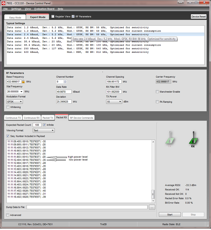

  • I tested the power levels at 433MHz and noted that it is not scaling as much as at 868MHz. There is a new version on the SmartRFStudio (v2.5.0) that has about 5 options ranging from 15dBm to 6dBm at 433MHz. Please update your SmartRFStudio to create a new table for the power levels.
    Prashanth

  • Hi Prashanth.
    It still stops after the 0009 packet number on smart Rf studio. If I comment the whole if statement the 2 set power levels continue alternating with no stopping.
    // if (seqNumber > 0 && seqNumber % 10 == 0 )
    // RF_close(rfHandle);         //added
    // RF_cmdPropRadioDivSetup.txPower = txpowerlevel[j]; // added
    // rfHandle = RF_open(&rfObject, &RF_prop, (RF_RadioSetup*)&RF_cmdPropRadioDivSetup, &rfParams);
    I have attached the picture of what I see in smart RF studio.
    Kind regards
    Julia

  • Sorry, I have 2 more questions. Hope they won't take as long to answer though.
    How do I add a pause after each power level increase? I would like to send again 20 packets, then pause for 2 minutes, and after that continue with the next power level. I tried the :  void Task_sleep(UInt32 nticks) function and insert Task_sleep (500000); in the if statement. After the first loop the packet number jumps, as you can see below. It continues doing that after the next loop too.  Why is that?
    16:12:44.518 | 0000 | SONOPILL4 |  -23
    16:12:45.017 | 0001 | SONOPILL4 |  -23
    16:12:45.516 | 0002 | SONOPILL4 |  -23
    16:12:46.016 | 0003 | SONOPILL4 |  -23
    16:12:46.516 | 0004 | SONOPILL4 |  -23
    16:12:47.016 | 0005 | SONOPILL4 |  -23
    16:12:47.516 | 0006 | SONOPILL4 |  -23
    16:12:48.017 | 0007 | SONOPILL4 |  -23
    16:12:48.516 | 0008 | SONOPILL4 |  -23
    16:12:49.016 | 0009 | SONOPILL4 |  -23
    16:12:49.517 | 0010 | SONOPILL4 |  -23
    16:12:50.016 | 0011 | SONOPILL4 |  -23
    16:12:50.515 | 0012 | SONOPILL4 |  -23
    16:12:51.016 | 0013 | SONOPILL4 |  -23
    16:12:51.515 | 0014 | SONOPILL4 |  -23
    16:12:52.015 | 0015 | SONOPILL4 |  -23
    16:12:52.515 | 0016 | SONOPILL4 |  -23
    16:12:53.015 | 0017 | SONOPILL4 |  -23
    16:12:53.516 | 0018 | SONOPILL4 |  -23
    16:12:54.015 | 0019 | SONOPILL4 |  -23
    16:12:59.019 | 0020 | SONOPILL4 |  -25
    16:12:59.516 | 0030 | SONOPILL4 |  -25
    16:13:00.017 | 0031 | SONOPILL4 |  -25
    16:13:00.516 | 0032 | SONOPILL4 |  -25
    16:13:01.015 | 0033 | SONOPILL4 |  -25
    I would like to change the data rate to 500kbps. If I change the smartRF settings.c to this code below, would that give me the required data rate? Or is it only possible to use 50kbps?

  • Hello Julia,
    1. On the first question it is not clear to me what you are printing and what you mean by packet number jumps. Can you share the code if you think that will better help us understand.
    2. For changing the data rate, please use SmartRF studio to identify the RF parameters that will work at 500Kbps. Change the deviation to 250kHz(modulation index of 1). Then increase the Rx filter BW until, Tx/Rx work successfully. Below settings worked for me.
    Symbol Rate = 500kBaud
    Deviation = 250 kHz
    Rx Filter BW = 1243 kHz
    Once you have it working in SmartRF studio, you can click on export code in command view and overwrite the smartrfsettigs.c file with the new parameters. This way you can update your settings to do 500kbps.
    Prashanth
  • Thank you Prashanth. For 2. I will do as you said. and for 1. I am showing you part of the code below.
    I only added the task_sleep function and with this 20 packets are received, break of 5s and the 21st packet with new power level is received, but then the loop or packets jump straight away to packet 31, continue rolling to 40, 5s break, and jump again. I would like it to do: packet 0-19 received, 5s break, 20-39 with new power level received, 5s break,...

  • I was trying to send and receive packets in an interval of less then 125ms. Best would be 15ms, and from what I understand that should be possible for the cc1310.
    Unfortunately the CC1110 does only show every hundreds packet for example in the smart Rf studio if I set it to a higher interval rate. Is there a way of receiving all the packets? I won't be able to program teh cc1110 though as I only have the eval module which is attached to the TrxEB board.
    Thank you for your help
    Julia
  • Due to how SmartRF Studio the communication between the PC and CC1110 is low. For this reason you should not use SmartRF studio to check how fast you manage to receive packets. To test speed you have to implement your own firmware on CC1110.
