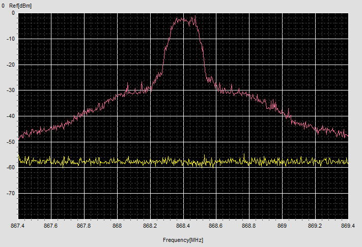

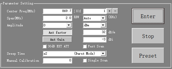

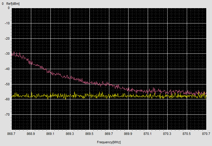

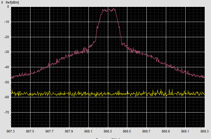

the RF signal at the shoulder is too high
Other Parts Discussed in Thread: CC430F5137, TEST2, CC1101, CC1120
I am developing a CC430F5137 based  RF product but I found the RF signals at the side of the spectrum chart is too high.
Please advise.
Thanks a million.
-derong
dyuan@seabreeze.ca
The picture below is the RF spectrum chart.
Below is the RF settings and part of the code.

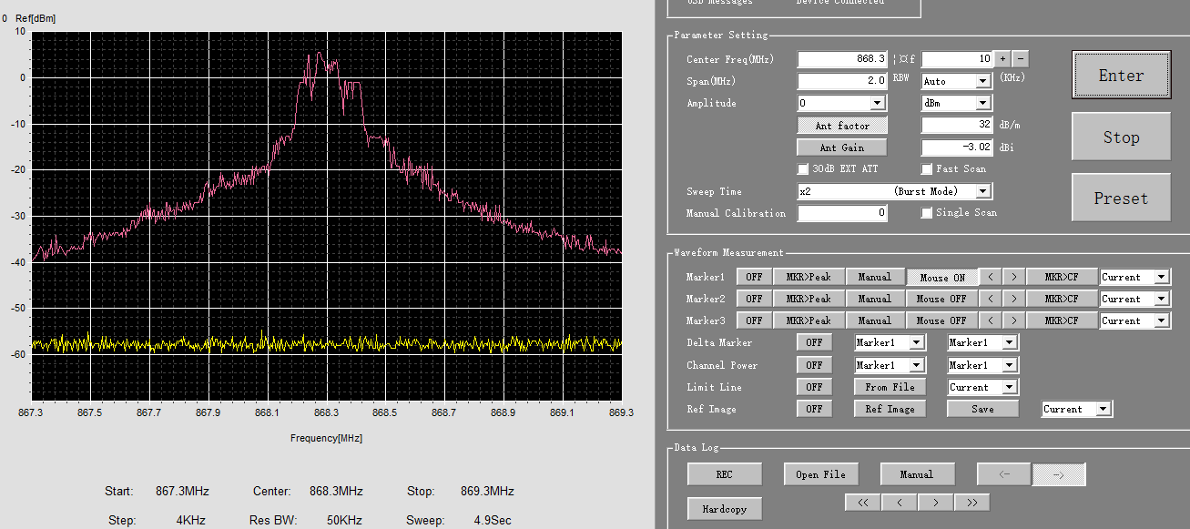

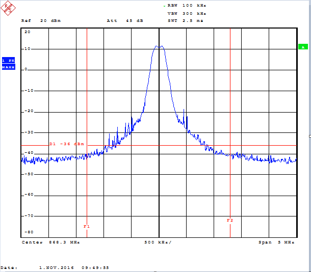

  • Your plot seems reasonable. You will pass ETSI EN300 220 V2.4.1 modulation bandwidth requirements so I do not understand your question.
    Regarding register settings. Use "175 kbaud, +/-95 kHz deviation" as starting point and change the deviation to 50 kHz. This ensures that some of the registers related to receiver bandwidth are set correctly (e.g FIFOTHR, AGCCTRLx, TEST2/1, FREND1)

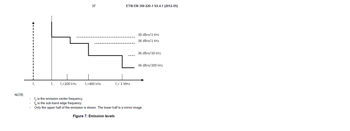

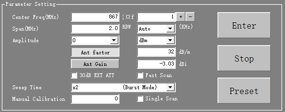

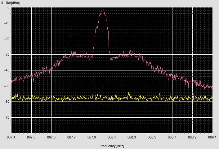

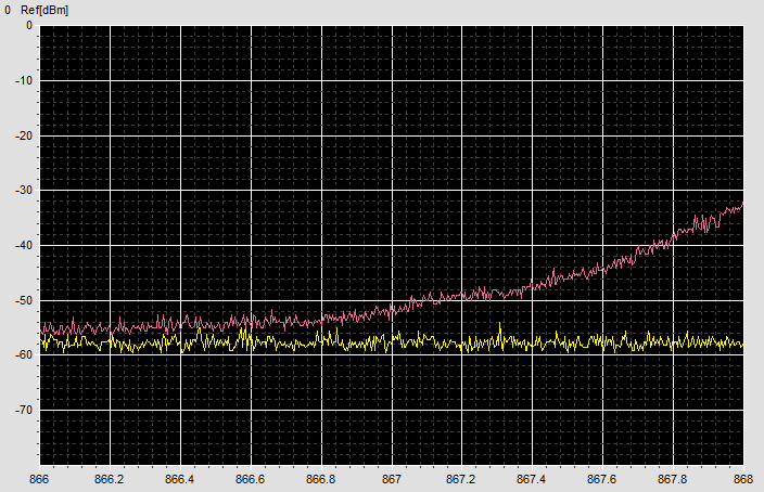

  • Thank you for the comments Sverre. But my product has just failed in the emission level test of the ETSI EN300 220 V2.4.1. So I was asked to make the transmitting power (dB) down below the limit of -25DB for the bandwidth 868.0Mhz to 868.7Mhz by any means. Please advise.
    Below is the description of the emission level copy/paste from the ETSI EN300 220 V2.4.1:

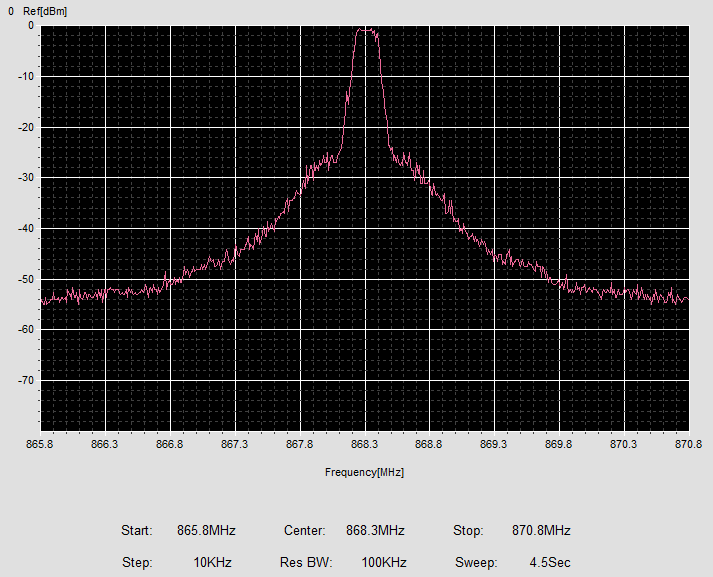

  • In your original plot you used a RBW of 50 kHz. You shall use 1 kHz, 10 kHz or 100 kHz depending on the offset from the 868.0 and 868.6 MHz band edges. When you do the measurements you should be in continuous TX, transmitting random data. Do not send packets as the there will be splattering effects when switching the PA on and off.
    The measurement should be done in 4 steps and the limits are
    1) -30 dBm at frequencies below 868.0 MHz and above 868.6 MHz. RBW = 1 kHz
    2) -36 dBm at frequencies below 867.8 MHz and above 868.8 MHz. RBW = 1 kHz
    3) -36 dBm at frequencies below 867.6 MHz and above 869.0 MHz. RBW = 10 kHz
    4) -36 dBm at frequencies below 867.0 MHz and above 869.6 MHz. RBW = 100 kHz

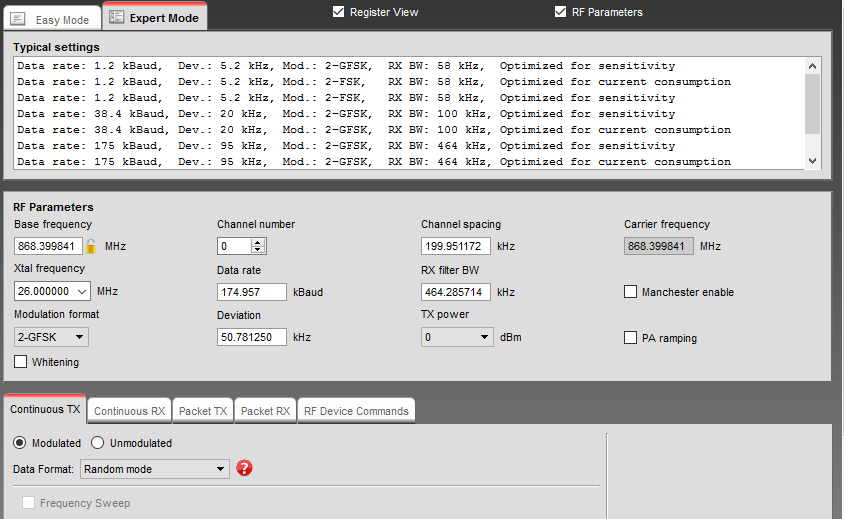

  • here is the RF setting generated from SmartRF for continuous Tx and transmitting random data:

    below is the testing software:

    but the measured RF signals at the shoulder are still high.
  • I download the "slac525.zip" and unzip it.  Then load the example code as a workspace "RF_Examples_IAR.eww" into IAR Embedded Workbench IDE.
    Compile the code "Asynchronous_comm_Tx.c" in project "Asynchronous_comm-Tx_MHZ_868", then run the compiled code  in EM_CC430F5137-900 evaluation board.
    Below is the plot for conducted emission measured the with a USB mini spectrum analyzer from Triarchy Tech.
    Hard to say it can pass the CE test.
    Please advise.
    Thanks.

    the  RF setting in SmartRF is:
    the RF register settings are:

    below are 3 measurements for the conducted RF test:

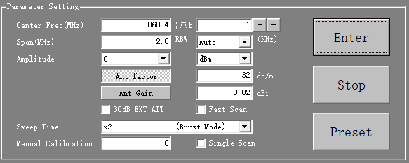

    1. to measure the central RF power the spectrum analyser setting is:
    the RF plot is:
     2. to measure the RF power before 868.0Mhz the spectrum analyser setting is:
    the RF plot is:
    3.  to measure the RF power after 868.7Mhz  the spectrum analyser setting is:
    the RF plot is:

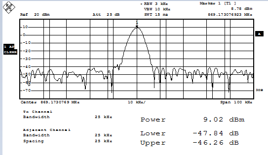

    Below RF plot is what I found from TER's reponse to a post by Konstantin  in TI's forum " CC1101 compliance with EN300-220-1":
    I don't know how TER could get the near perfect RF spectrum plot.
    But he did not answer Konstantin's question: if CC430F5137 can be used in his alarm product which has passed the EN300-220-1 standard with cc1120.
  • Your spectrum analyzer cannot be used to measure the modulation bandwidth (MBW) according to EN 300 220. When you select RBW = "auto" the BW will not be 1 kHz or 10 kHz.
    Below are plots showing MBW for the different RBW and limits. Data rate is 175 kbps, deviation +/-50 kHz, GFSK modulation, 868.3 MHz.
    RBW = 1 kHz. Limit: -30 dBm. F1 and F2 are 868.0 MHz and 868.6 MHz (band edge)
    https://e2e.ti.com/cfs-file/__key/communityserver-discussions-components-files/156/1kHz-RBW-BandEdge.WMF
    RBW = 1 kHz. Limit: -36 dBm. F1 and F2 are 867.8 MHz and 868.8 MHz (band edge +/- 200 kHz)
    https://e2e.ti.com/cfs-file/__key/communityserver-discussions-components-files/156/1kHz-RBW-BandEdge-plus-200kHz.WMF
    RBW = 10 kHz. Limit: -36 dBm. F1 and F2 are 867.6 MHz and 869.0 MHz (band edge +/- 400 kHz)
    https://e2e.ti.com/cfs-file/__key/communityserver-discussions-components-files/156/10kHz-RBW-BandEdge-plus-400kHz.WMF
    RBW = 100 kHz. Limit: -36 dBm. F1 and F2 are 867.0 MHz and 869.6 MHz (band edge +/- 1000 kHz)
    https://e2e.ti.com/cfs-file/__key/communityserver-discussions-components-files/156/100kHz-RBW-BandEdge-plus-1000kHz.WMF
  • Thank you very much for your quick response Sverre.
    I tested the code again in the eval board EM-CC430F5137-900 and measured the RF power with the same spectrum analyser with RBW =100kHz. Then I compared my plot with your plot (measured with RWB=100kHz) and found they look too much different.
    Could you post your RF settings generated from SmartRF so I can see if my RF settings are wrong? Do you test your software in the eval board EM-CC430F5137-900?
    my spectrum plot with RBW =100khz:
    your spectrum plot with RBW=100khz you posted at Nov1, 2016 7:31AM:
  • Sorry for the delayed response. I used CC430EM for my testing. The register settings are those you get from SmartRF Studio if you select "175 kBaud, Dev 95 kHz" and simply change the deviation to +/-50 kHz
  • The Triarchy TSA5G35 spectrum analyzer can have very poor sideband spurs, poor phase noise, and modulation from internal digital noise, which will affect the results. It's fine for troubleshooting and detecting signals, but it's not a suitable instrument for compliance testing.
