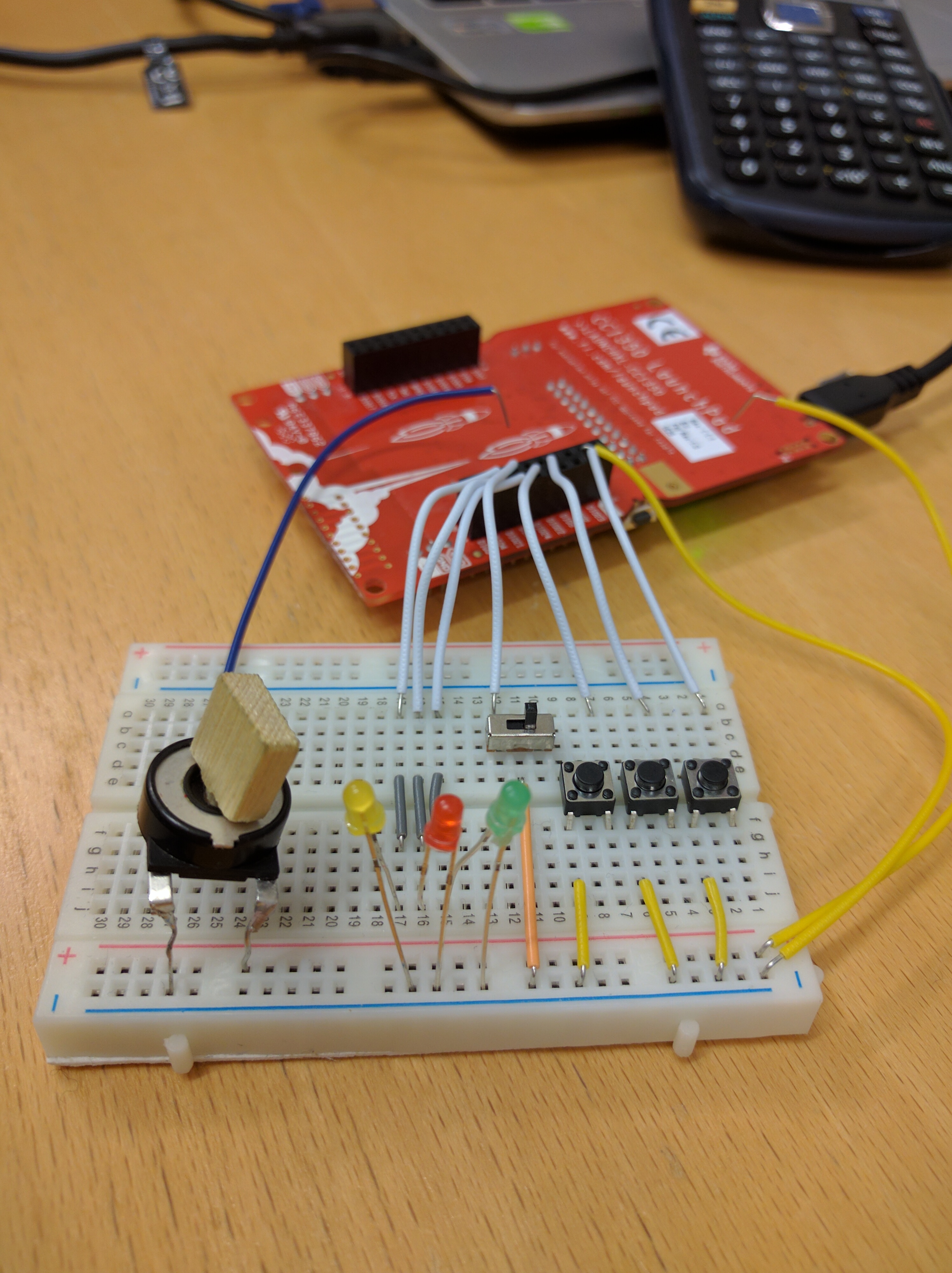

  3. Then copied moduleADC_zxc.c into the project and attached the potmeter to the Breadboard. When connecting "+"-terminal on the Breadboard to the 3V3-terminal on CC1350LP, something happened and I got the "HW ejected/HW detected" sound in Windows (the 3V3 PIN may also have touched the GND PIN).
  4. Trying to run all the modules and display both PIN-values and ADC-values on the UART doesn't work. The red LED never blinks, indicating that the tasks are never executed. When trying to comment out the moduleADC_zxc.c, thus running the system as given in step 2 above, I'm still not able print anything to the UART. Only when commenting out the UART module and go back to step 1 am I able to get the system running.

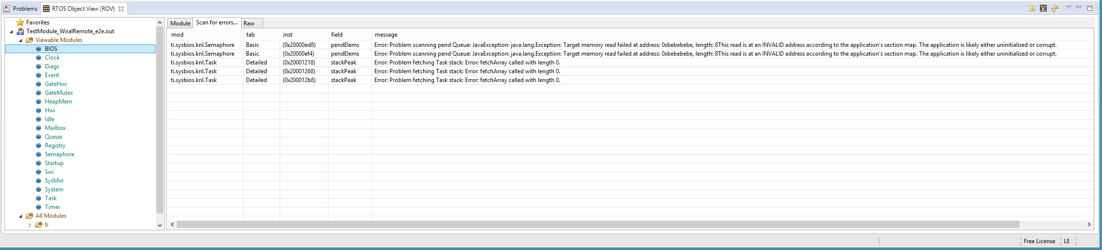

    In order to know what to look for in the code (and speed up the process), have you looked at the ROV? (In CCS, under the Tools menu)
    The ones that I am interested in are:
    BIOS-> Scan for errors
    Task->Module
    Task->Detailed
    Can you post some screenshots so I can see what is going?

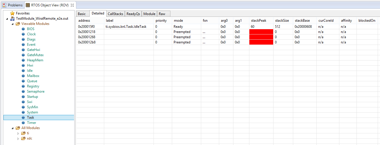

  • When were these screenshots taken? I am saying that because the stackBase is 0 for all tasks except for Idle.
    I guess I should have specified: can you take the snapshots when the program has failed and after BIOS_start() has started?

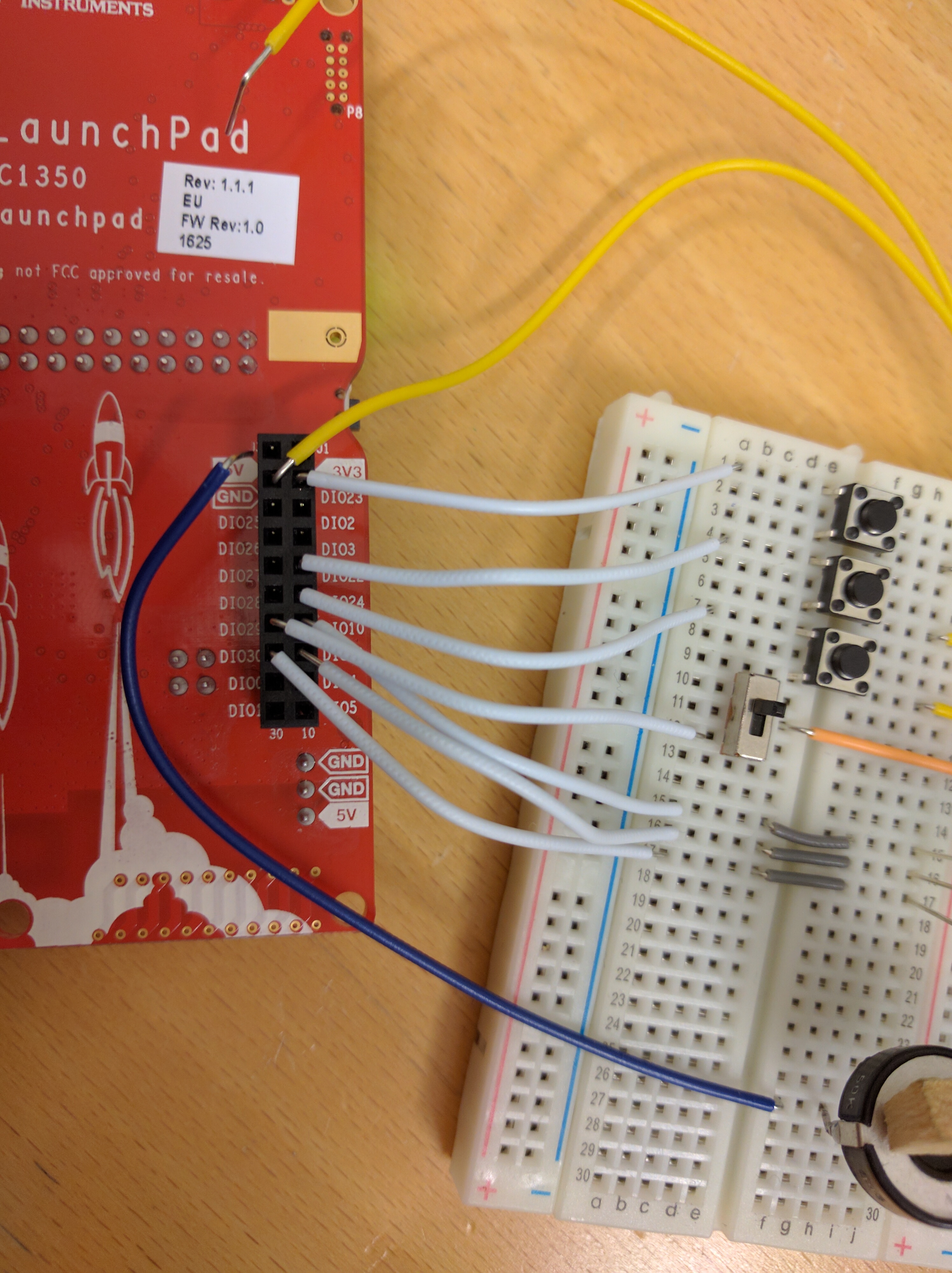

    As for the error, the fact that you have the Windows device ejected sound is never a good sign. This is probably because your potentiometer is not connected properly or draws too much current and causes the device to "power down". Continuously doing so could damage the board (which might already be the case). What kind of potentiometer are you using and how many Ohms?
    Can you attach a quick schematic of your ADC connections? On paper is fine.

  • What does it mean that stackBase is 0 for all task except Idle? What did you expect?
    I cannot give you screenshots after the program has failed as the ROV shows "Target is not connected". I checked a few times and the ROV (BIOS->Scan for errors, Task->Module and Task->Detailed) did not change or update values in the time between I press "Resume" and when it crashes. The same values was also given before I pressed "Resume". It takes about 3-5 second from "Resume" till it crashes. The screenshots I gave you are therefore the only values I have. In my project now I only run the GPIO module and the UART module.
    I agree that the windows eject sound is bad news. The potmeter is 50kOhm, and I have managed to get it working both in CCS before and using Sensor Controller Studio. Both in CCS and in SCS I was able to output a maximum raw data number of about 3200 (of a maximum 12bit number of 4096). I connected the potmeter to the 3V3 PIN and the GND PIN, and connect a analog capable PIN for the readout, I now use DIO28 (Note that I lodded on legs on the potmeter to make it more usable). A picture of the potmeter and the simple circuit is given below, and a picture of the potmeter connection to the Breadboard is given in my original post above.
    I managed to run an empty project on the connected CC1350LP, and I got the LED blinking as it should. meaning the board isn't completely broken. Now, as mentioned above, the project crashes each time I run it even if the moduleADC is disabled. I suspect there may be error with how i construct and run the UART module, or maybe even how I use Tasks of the TI-RTOS.

  • Hi Birger,
    stackBase should correspond to the location (address) of the stack in RAM. The address would be located in RAM which starts at 0x2000 0000. So 0 means that it has not been initialized (i.e. after BIOS_start() )
    Disconnect the ADC and try placing a breakpoint on the first line of each task. You should that the values in the ROV views will change.

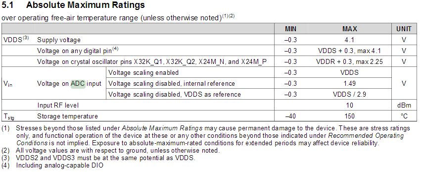

    The ADC can use a "scaled" reference of ~4.3V so the max value that you should obtain is 3.3 / 4.3 * 4096 = 3143.... But do not exceed the absolute maximum voltage shown in the table that I attached in my previous post.

    A possibility would have been that the potentiometer would draw too much current from your launchpad, but 50K will not draw enough current from the power supply to cause what you are seeing.
    The Windows eject sound leads me to believe that this is a hardware related issue and not necessarily a software issue. The ADC reads a value and it has a high impedance at its entrance so no current should be flowing in or out of the GPIO pin (unles something went wrong). Can you measure the voltage on each pin of you potentiometer for your own sake that everything is as you expect. I would also connect your potentiometer to a breadboard with an external supply just to make sure that it is not damaged (i.e. your voltage on the common changes as you turn the dial on the potentiometer)

  • Hei Michel
    Update: I managed to remove the error and get the system working by examining the ROV with breakpoint as you said. The problem seems to be that the UART task was given the highest priority, and giving this task the lowest priorty fixed the problem.
    Now this of course brings up many new challenges for me as I have to learn tasks in detail (I couldn't get the LEDs blinking no matter the priorty I gave this task), but this is still progress. I thank you very much for your help and will mark your last reply as a verified answer. I would still appriciate it if you could give me some feedback on my code architecture, but I understand if you don't have time or feel that this is my own responsibility to understand. Thanks very much for your dedicated help.
