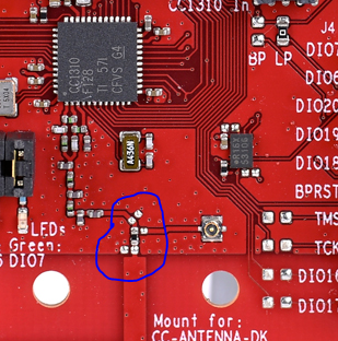

    You can confirm that the PCB antenna is selected by checking that your LP looks like in the picture.
  •  Thanks Ter,

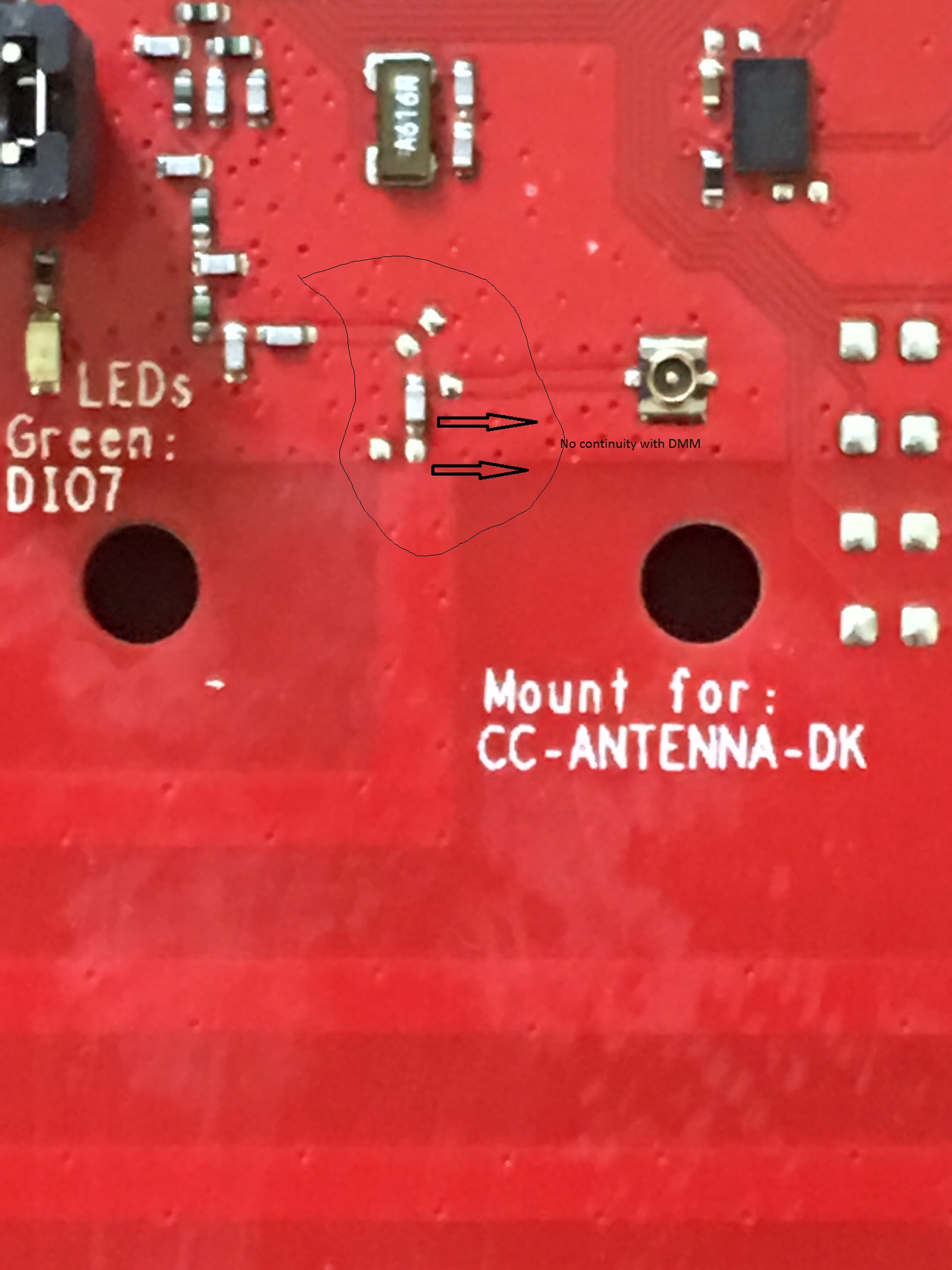

    I have the same layout but when I checked with the DMM and found no connection between the soldering point below the 0 ohm resistor and the resistor itself. That is the case in both the launchpads I have ! Is that normal ?
  • How do you measure this? Is it possible to place the arrows between the two measurement points? If the measurement is done where you indicate with the existing arrows, is it possible to take a picture a bit more from the side showing the soldering?
    Note that the component placed is a 1.8 pF cap.

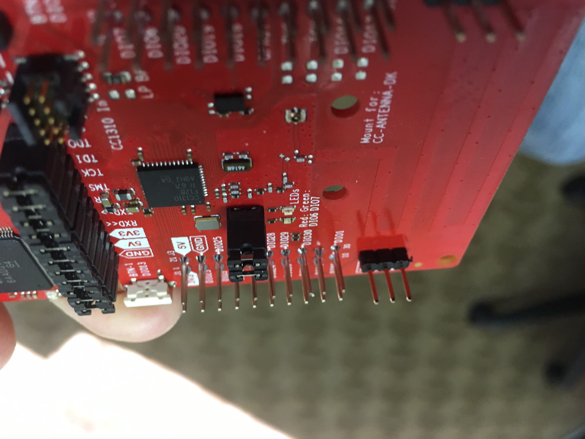

  •  I placed the DMM on the soldering point of the resistor and the soldering point beneath it (probably the embedded antenna). From the side there is no direct connection between these 2 points.
  • So basically you have modified the Launchpad? Sometimes components start to rise to one side, typically when doing a manual soldering and care has to be taken to ensure that the soldering is good.
  • No i didn't solder or modify anything. I just measured with the digital multimeter ! The card came like this.

  •  I soldered the point between the resistor and the PCB antenna on both cards and still can't get more than 10 meters ! The green line in the image is where I add the solder to connect the 2 points. I feel that this components at the soldering point is not a zero ohm resistor as described in the schematic ! It doesn't give me a buzzer or zero ohm when I measure it with DMM.
  • I misunderstood slightly where you measured no connection. I thought it was between the component itself and the PCB. According to the layout files (www.ti.com/.../swrc319, see the LAYOUT.pdf file) it's a track from the component pad to the antenna. I find it difficult to understand why you should have a open here.

    In your earlier drawing, it is a bit difficult to say exactly where you are measuring, could you please explain again? You should be measuring continuity along the circuit trace, but not across R12, as this is not a 0-ohm resistor, but a 1.8 pF capactitor, which will block DC. If you want to use the JSC connector, you should remove R12 and place a 0-ohm resistor in the R13 position, sorry if this is not clearly explained.

    I have traced the connection and I understand it now. I think I was right about the missing connection between the R12 (1.8pF capacitor) and the PCB antenna. This was indicated by the green line I showed on the image before. I have completed this missing part by soldering in both the cards and still have the same issue with the range. If you looked at the side image I sent before placing the green line, you would probably recognize the missing solder.
