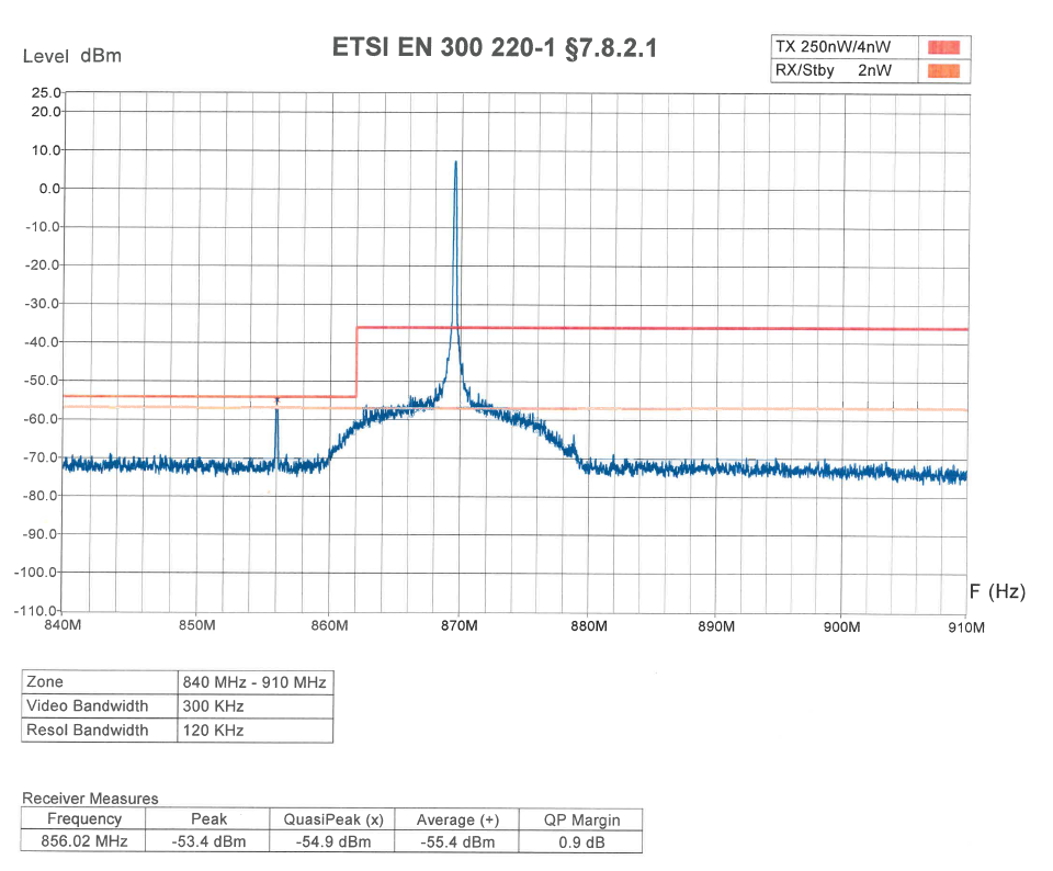

In order to confirm that point I made some measurements regarding the 7.8 "Unwanted emissions in the spurious domain":
- DUT: cc1101+cc1190 with SAW+integrated balun in between. RF filters equivalent to reference design "cc1101_cc1190EM 869MHz"
- cc1101 crystal frequency: 27 [MHz]
- method 7.8.2.1 (the module doesn't have any antenna, only a SMA connector)
- central frequency: 869.525 [MHz]
- nominal power: see pictures
- temperature: 23°c

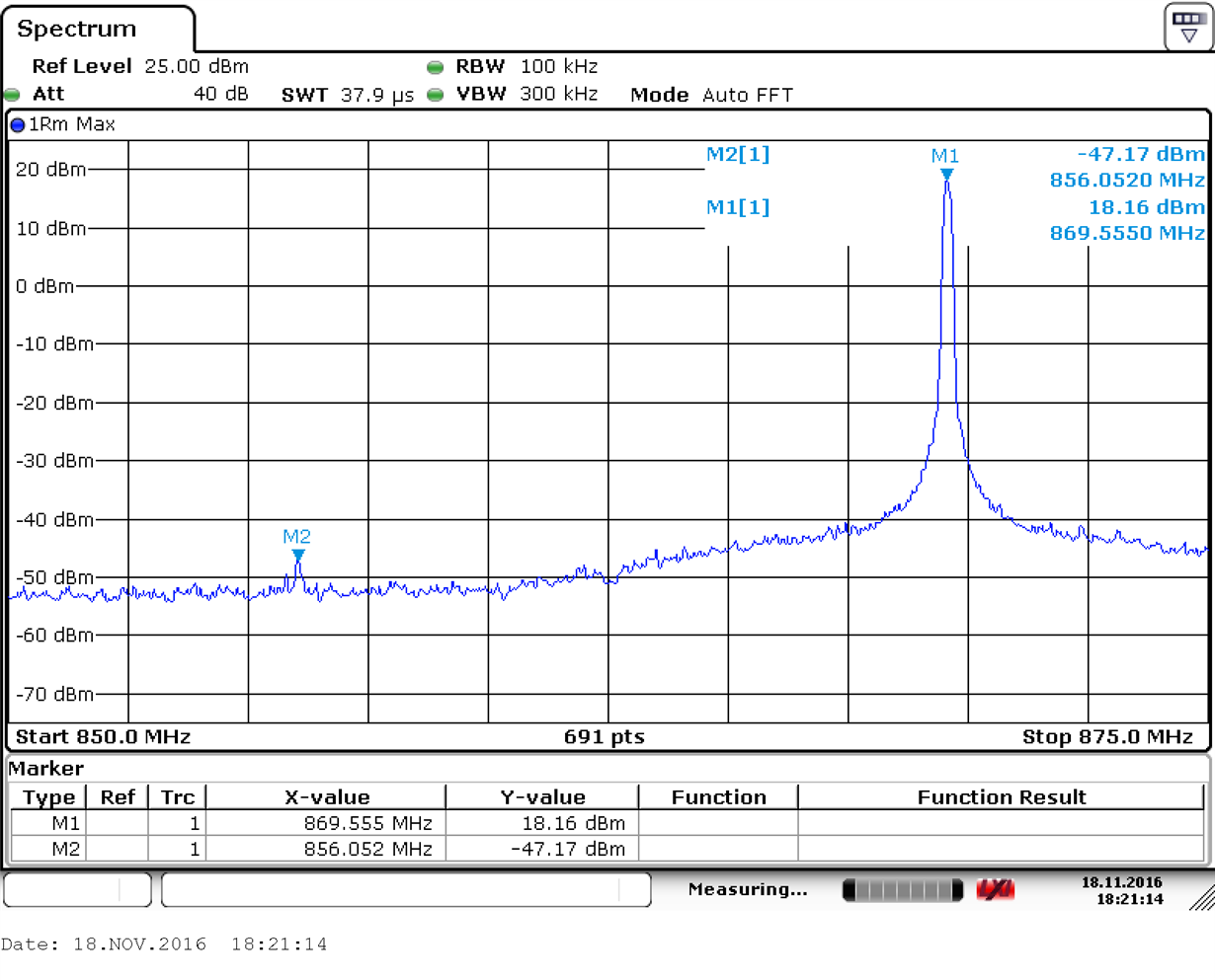

It appears that the spur do not appear at 864 MHz but at 856.02 MHz:

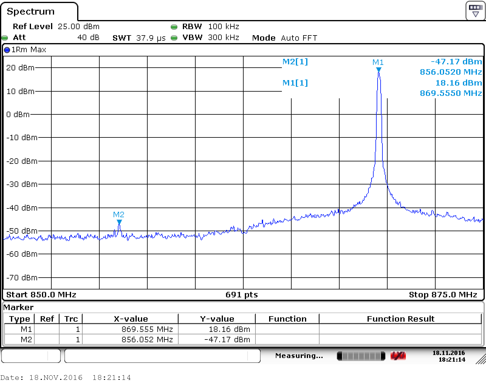

I decided to decrease the power and see how the spurs are changing:
The spur at 883.02 MHz seem to be generated by saturation, as it disappears whenever I decrease the output power (it actually disappears under noise with an output power of ~15dBm).
Anyway, the spur at 856.02 MHz is inside the template with an output power of 9dBm or lower. Above 9dBm, it exceeds the template, and with the nominal 23dBm output power, in is 8dB too high. Furthermore, It is not on the 864 MHz frequency, as stated in AN094.
Could you please help me figuring out
1) why it is not on 864 MHz (given by the app note AN094)
2) how can I decrease this spur
