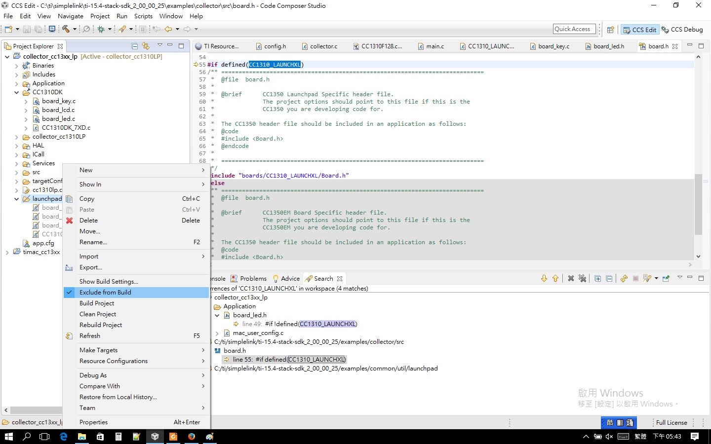

  • Using CC1310DK as an example,
    1. Create a CC1310DK folder in CCS project explorer and add related board files into the folder.
    2. Exclude original launchpad board file folder
    3.  Change "CC1310_LAUNCHXL" in Predefined Symbol to your own board define such as CC1310DK_7XD.
    4. Search "CC1310_LAUNCHXL" predefined symbol in project and add CC1310DK_7XD accordingly.
