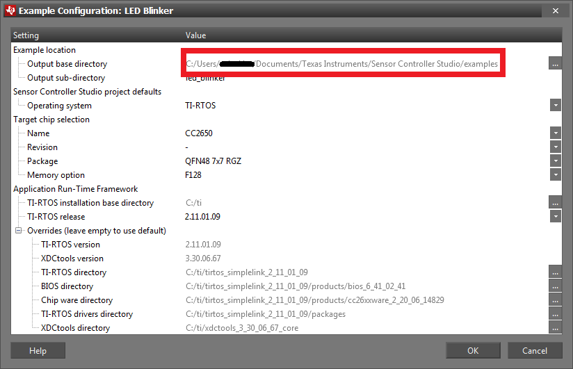

    When you installed Sensor Controller Studio, some examples were also included.
    1. Open SCS and on the start page, open and create one of the examples at the bottom. During creation, you should have seen an output base directory (image below) and the sub-directory. That is where the files will be located.
    2. Open that folder on your computer.
    3. You should see a source folder, open it.
    4. You should a file called main_tirtos.c (you should also have all the other .c files mentioned in your post)
    5. The main_tirtos.c will show how to include your output files to your project.
    Try opening the different examples too see what is possible to do with the sensor controller.
